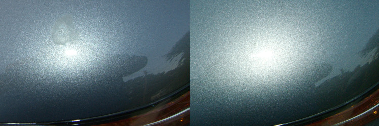

It finally happened, on a personal level. My wife who works in a salon, takes the Expedition every day, to a crowded parking lot, and is left with whatever spot available to park in. So she comes home one day last week with this 2ft long scratch on the rear left side of our Expedition. I thought, "Well, maybe its just a transfer". So I got some QD just to clean it up and further analyze it. To my dismay, nope, its a scratch. I fig'd it was from a side mirror, obviously from some idiot who doesnt now how to drive, and probably doesnt even speak english. No note to apologize even. I mean even an anonymous, "sorry" would have been a little settling. Then I remembered, "Hey good opportunity for the Quixx German Scratch Remover System". So, without futher ado, heres my own experience with Quixx GSRS.
It has been a while since the Expedition has been washed, and todays probably not a good day due to local brush fires. Theres a decent amount of fallout from a fire 60 miles away. The winds have switched allowing ample ash fallout at my local. So a quick gentle dry wipe with a MF (Your wondering why "dry wipe?" Ashes and water dont mix, it reactivates the caustic properties of ash fallout).
Heres some befores:
First up was the Polish One (as directed). I took the included wipe they provide, added a fingernail size drop, and proceeded to apply in the same direction as the scratch, until the product hazed/dried, and couldnt rub in, any more. Probably 10-12 seconds of back and forth motion. Polish One is the most agrressive of the two, for deeper scratches. Then wiped with a MF. Here you can see the differences between Polish One, and the untouched 1/2.
It really cleaned up the scratch rather well I would say! Polish One is not something you would want to use over a large area. Its really aggressive!
I wanted to stay as close to directions as possible, but couldnt bring myself to wiping with the other side of there provided cloth. It just seemed a little rough for removal, although certainly would have peformed well. Its just a personal pet peeve of mine I guess.
Next up, as directed, Polish Two, a much thinner, gentler polish, required for removing and marring which Polish On may leave, and it will. But dont be alarmed, its easily removed with the second step polish. I used the same technique as Polish One, except a used a little more then I wanted to, but theres no putting it back in, so away I went with Polish Two.
After Polish Two removal:
Heres an interesting picture. This is the second half of the scratch, after only using Polish Two. Its about 95% gone, with the single step, Polish Two. You would really have to know there was a scratch there to begin with, to even notice.
So as you can see, quite a versatile scratch removal kit. You have two polishes. One polish (Polish 2) for very light scratches, and one polish (Polish 1) for heavier, non apologizing, idiot induced scratches. Keep in mind, using Polish One will require using Polish Two to reduce marring.
And heres the final product:
Sealed up with Duragloss #111.
In summary, Quixx Scratch Removal System is a great product for quick fixes, and unsuspected scratches. We all get them, but few know how to properly address them. This German company has brought it to America to address a need that really hasnt been properly "pitched". Clear, concise directions, attractive bottling/tubing of products, includes wetsanding paper for the real tough ones, or for *rock chip repairs.
For rock chip repairs, clean chip, apply touch up. Let dry thoroughly, then use wetsanding paper, Polish 1, and Polish 2. Its really that easy. The hard part is not applying too much touch up. This will be my next venture on my own car (again). But giveme a few weeks to tackle that one. Its detailing season!

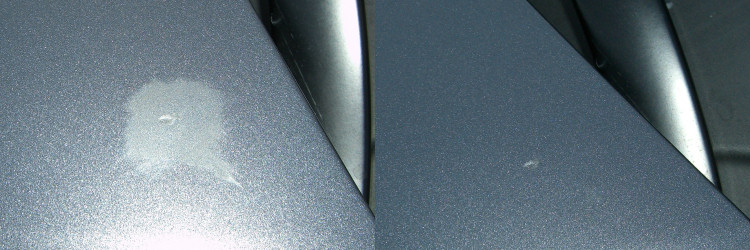

This past weekend I decided to clay my car for the first time ever and while I was at it I figured now was the best time to fix some rock chip damage I had to my paint. I had a few spots with exposed metal and possible rust formation, so I used some 400 grit sandpaper to clean the spot out, then some 1000 grit paper. Then I applied 1 coat of touch up, let it dry, sanded with 1000 grit, 2nd coat, sanded with 1000 grit, 1 coat of clear coat. Afterwards I was left with some nice ugly scratches/white areas around the rock chips due to the sanding. I was hoping that I would be able to get rid of them with a scratch remover, and I read about Quixx in this forum, so I thought I would give it a try.
I followed the instructions, wet sanded with 1000 girt, then the included 3000 grit, then used step 1 and 2. I am amazed how great this product works. Yes I know the paint doesn't match and still looks crappy...but certainly not as bas as it used to. The pictures on the left are after the last sanding, and the right is after steps 1&2.
BTW, I picked it up from my local Wal-Mart for 14.93. Two local Pep-Boys and an AutoZone didn't have it.

Mine worked wonders this weekend too, my question is... if I look closely with that "it's my car and I can spot imperfections in a heartbeat stare"
I can still see where I wet sanded, it is just realllly well hidden by the megs nxt wax and the 2nd stage quixx, did i completely ruin the paint? lol whoops, @ least it's not noticable to the naked eye...

I just used Quixx to remove a scratch on my door that ScratchX wouldn't touch. I sanded with the included 3000 grit (which scared me all to hell), then used tubes 1 and 2 and the scratch was gone.
This stuff is awesome.
