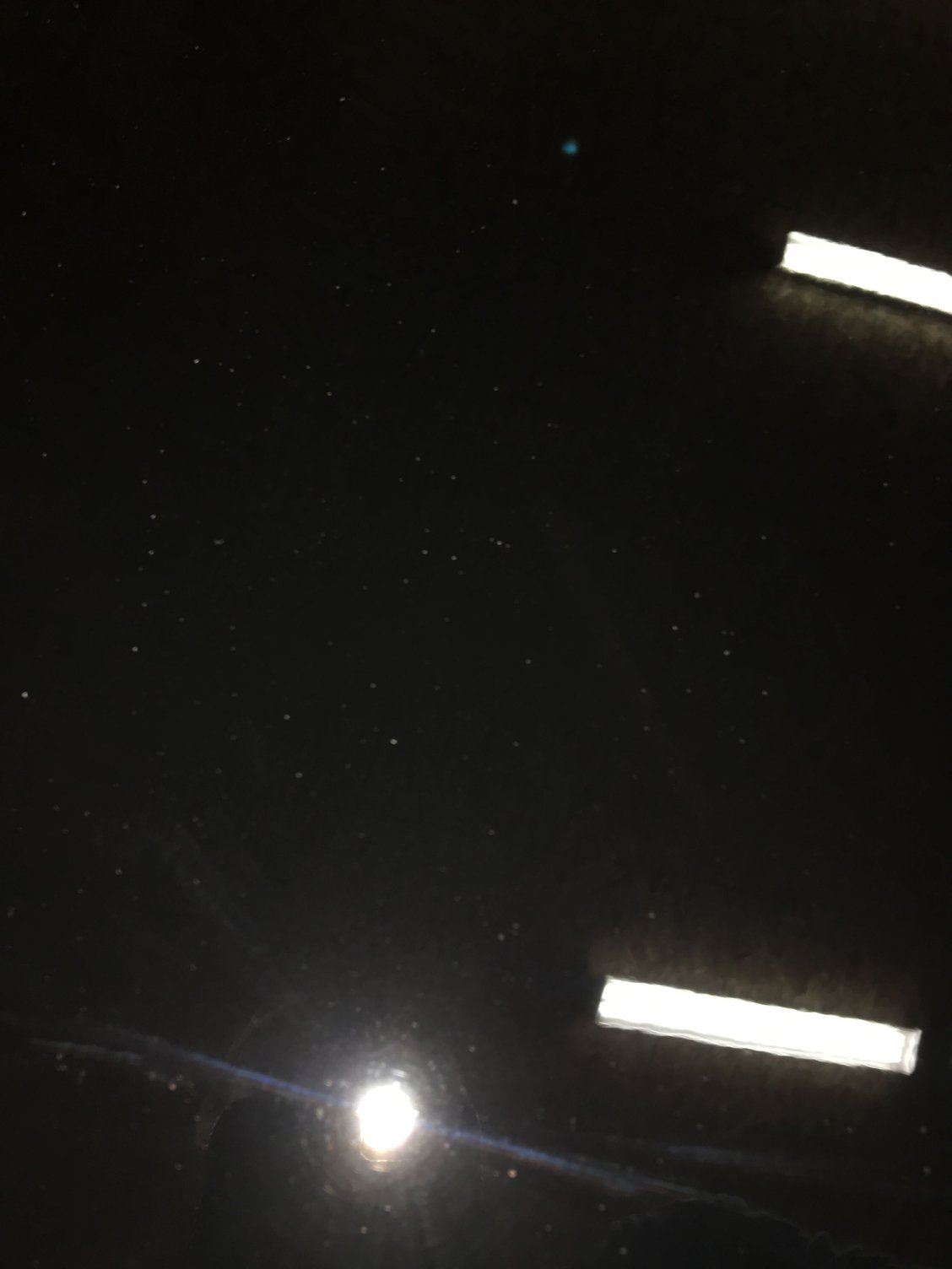

Sorry about the bad pics but here are some before

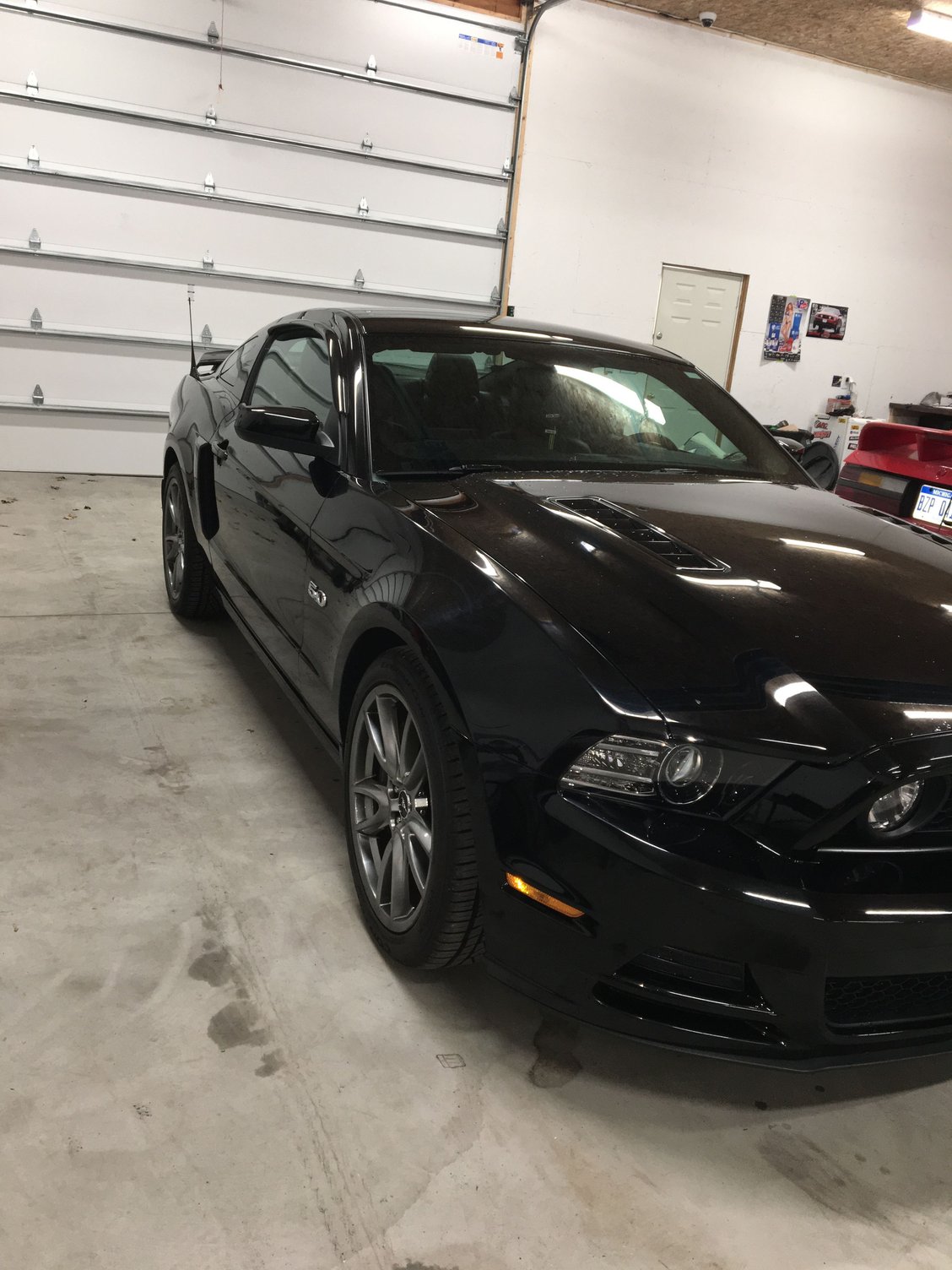

So my friend asked me to help bust out some swirls on a 14 Mustang gt. The owner is 20 and knows nothing about cars, runs this thing through the auto scratcher at the dealership he works at every week. After about 3 hours of us both working on it she looks beautiful again. The lesson here-Stop using the auto carwahes with brushes-your car will thank you

Car turned out great. I am not a fan of black because it shows all imperfections but gosh it looks good when it’s all cleaned up.

Are you familiar with buffing or waxing? You will probably get some different response but First I wash/clay bar the car at the same time. Then I use a 2 step procedure with an orbital polisher-not a traditional spinning buffer because if used incorrectly it can really screw up your finish. Step one is a gritty compound for rough swirls/scratches and 2 is a more fine compound-give it that deep look. To finish it off I just wax the car. Im sure there is a tutorial for it and might be different from what I do with different terms.
