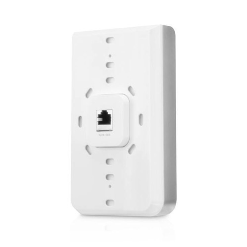

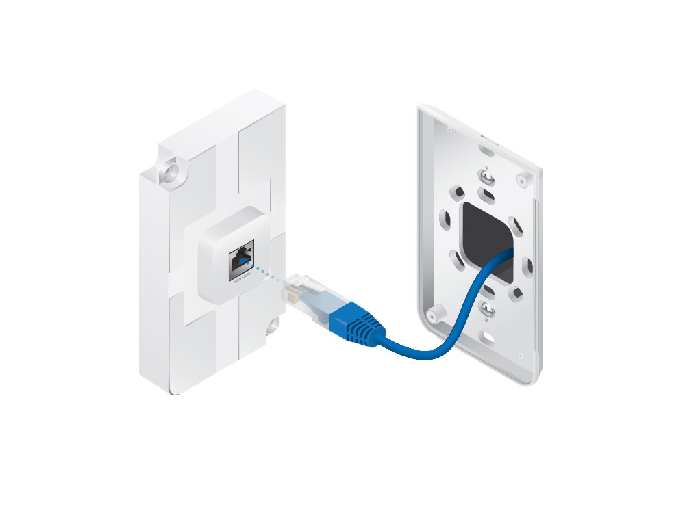

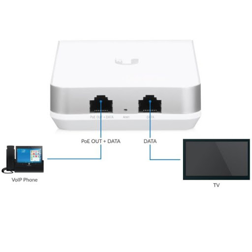

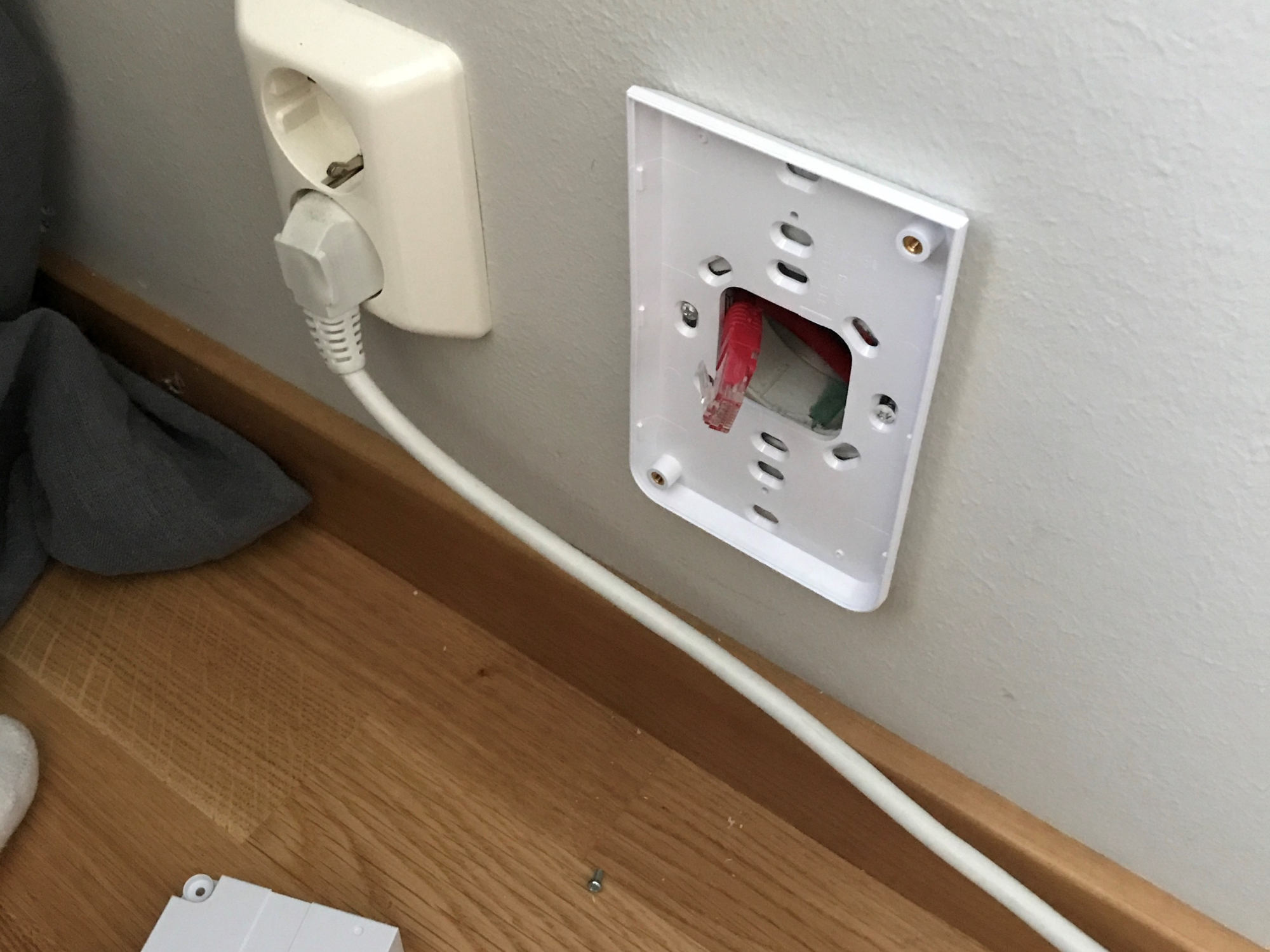

When I moved into where I'm at now, the first thing I did was run Ethernet into every bedroom, fuck Wi-Fi. I ran that shit through the attic in June in Florida. I ran Cat 6 so now I can definitely upgrade to 2.5 Gbps Ethernet, and probably 5 Gbps when that becomes more common. Once you run Ethernet then you can install a WAP back in that room and extend your Wi-Fi. I'd recommend something like the Unifi AC In-Wall. I have one in my bedroom, it's powered by PoE, provides Wi-Fi to the back half of the house, and has two passthrough Ethernet ports, including a PoE passthrough, so I'm powering my 5-port Unifi Flex Mini switch off of that PoE and I connect my PC, Mac, and PS4 to it. You'll need a PoE injector or PoE switch. I've got the AC In wall powered by an unmanged 8 port PoE switch (15w max per port) and that 15w is enough to power the In-Wall WAP and the 5 port Flex Mini switch connected behind it. The In-wall has all the slots in the back so it will work with any low voltage gang box or bracket you choose, the home depot old work LV brackets work great.
Amazon Amazon
Once the Ethernet is ran you're set for life, you never have to worry about it and it greatly expands you capabilities of what you can put in that room. Run it in the fall when it cools down, it's soooo worth it.
