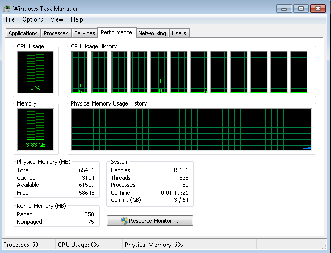

New i7 machine is built!
A bug :FU: to Coolermaster and MSI though...
Coolermaster insisted I use the wrong standoffs on a 2011-v3 board to mount the Hyper212evo, I may need to remove the cooler later and clean up the excess/messy thermal paste resulting from having to remove the heatsink several times...
MSI for giving me a effed up and incomplete diagram of the memory channels. I have since moved the four sticks of RAM to the 1, 2, 3, 4 slots to the left of the CPU and they all register as a total of 64GB. In 1, 3, 5, 7 as directed by MSI (kind of, lacking documentation), I saw 49GB of RAM.
Installing W7Pro now.
I only have the 256GB SSD in right now for the OS and programs. Later, will add a 2TB spinning platter drive and probably a 500GB M.2 drive (some of my programs prefer a super fast cache).
This case is awesome. VERY well thought out and put together. It's big, but it does not disappoint. Will probably pick up two more 120mm fans for the top fan cage that is just filtered venting right now.
