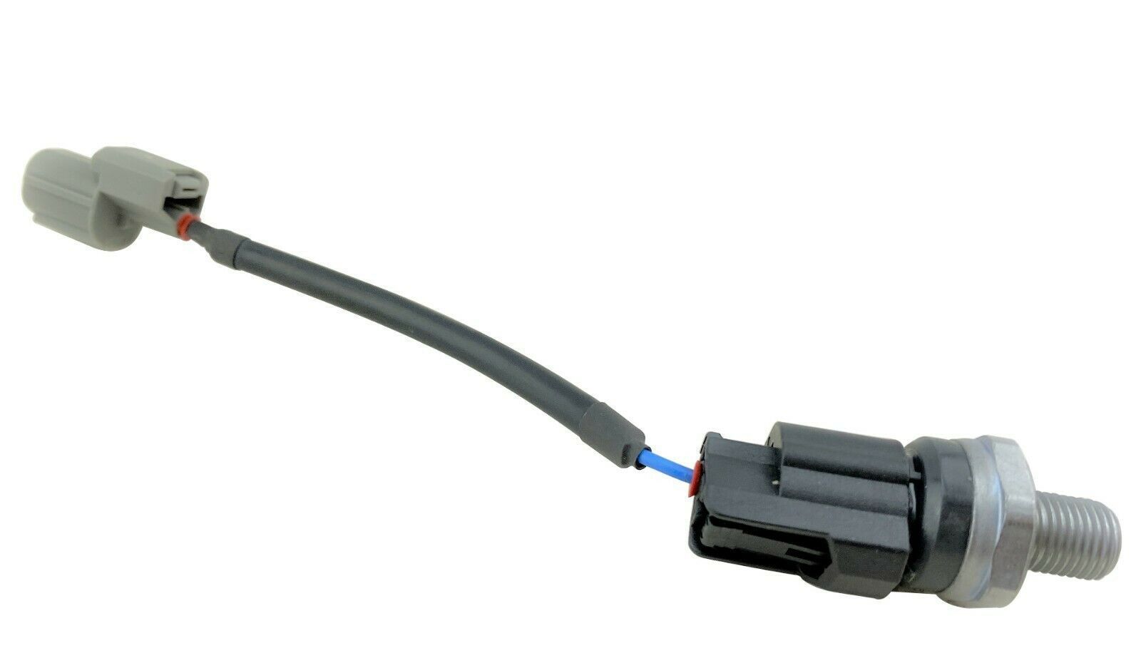

the knock sensor is the electrical sensor...on the J-series engine, the knock sensor is buried beneath the intake manifold and it's runners.
the k20 - the knock sensor is located underneath the intake manifold.

I had replaced Knock Sensor last year, so most likely it is not the issue. I guess after cleaning electrical connectors, I didn't connect one of them properly and that connector is related to Knock Sensor. Can you please point me to which connector it might be?

yes, the knock sensor.
the electrical component/connector clips onto the knock sensor.

Thanks for your post again. From top of the engine, where can I find other end of the connector which probably I cleaned and left loose?

attached to the wiring harness very close to the knock sensor

at 4:10 you can see the wire near the starter
and it's actually apart of the engine wire harness, meaning you didnt forget to plug it back as it can't be unplugged at all.
