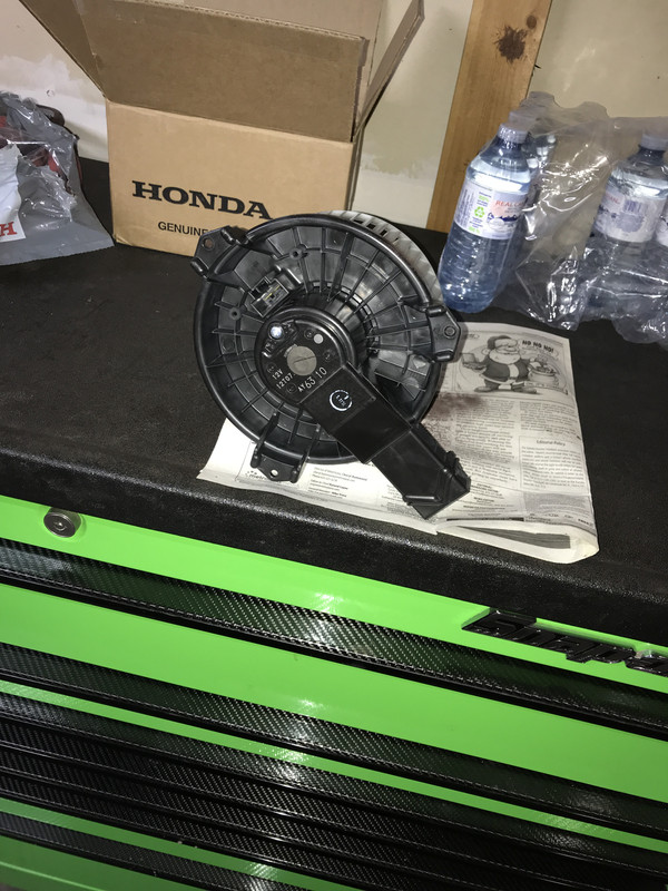

This will be the 3rd time I'm replacing the hvac blower motor in this shit 2016 ILX. When replacing it the 2nd time I took the motor apart to see what was making this faint burning smell and sure enough the bearings where eating it's self and aswell as the brushes and the turbine, creating this very fine dust that when checking the tubing vents right after the blower motor where coated with it. I wiped down the inside on the vents as far and I could reach and replaced the blower motor. Now it's doing it again 3rd time this is just another stupid Honda design.
-When I install it myself 30 day warranty
-The dealer installs 1 year / 20,000 kms
ILX now has 232,000ish kms
Takes 10 mins to replace, remove plastic cover with pull tabs and the motor has 3 screws and unclip the wire harness , so I'm going to get the dealer to do it this time as I'm sick of paying $70CAD for a motor every year.
I get the dealer to save the old motor and will take it apart to pictures to post here.

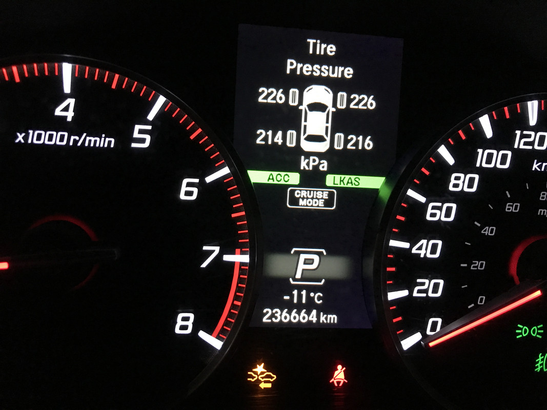

well with 10k you won't see any of these symptoms, that's like comparing one from the show room, c'on man! and yes, 236,664 kms as of today

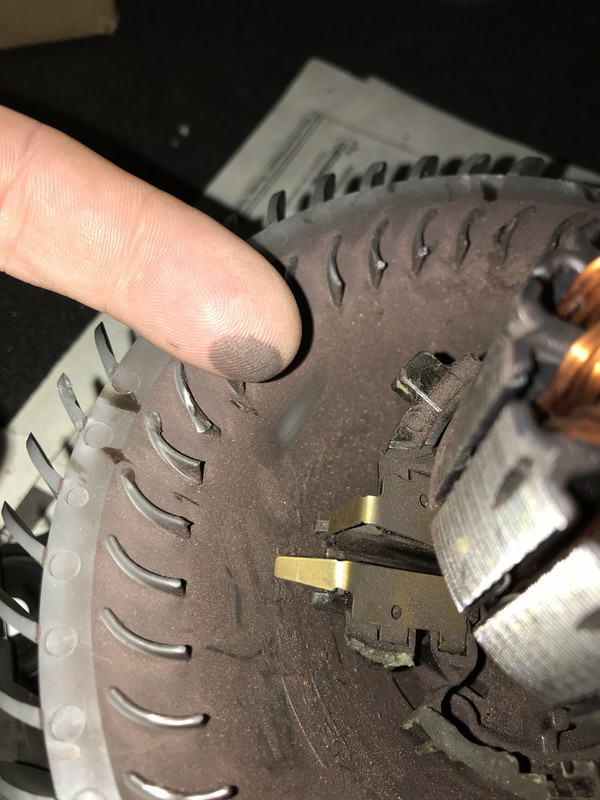

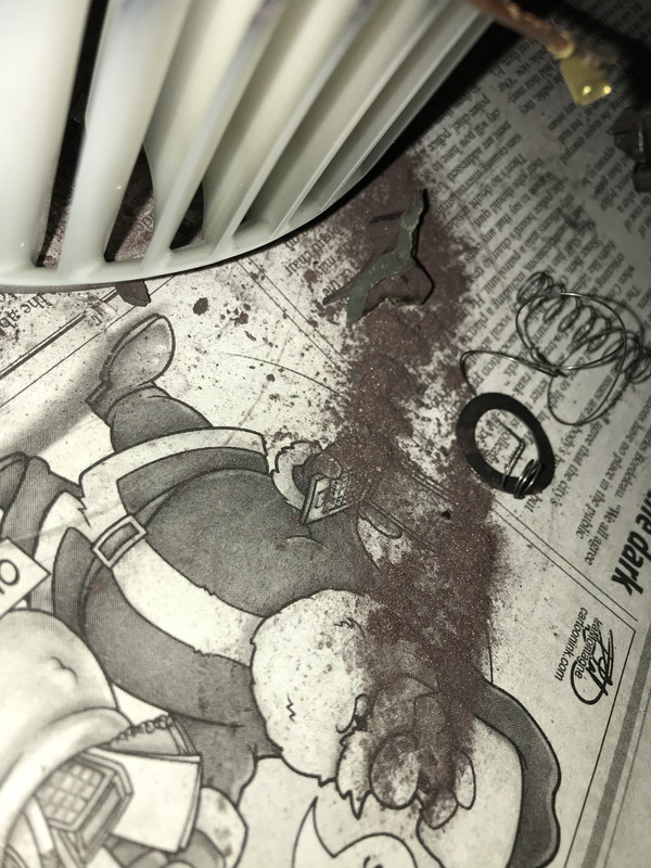

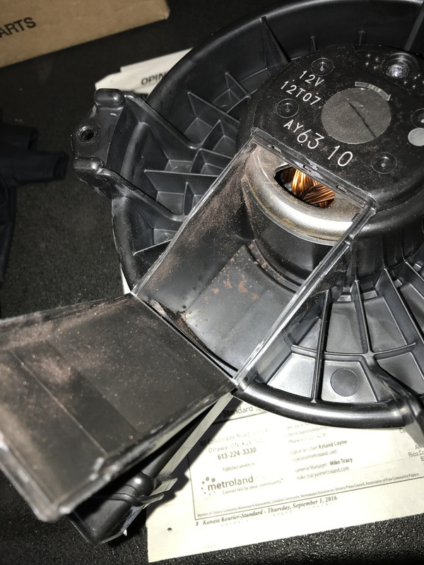

As you guys can see the brushes are wearing the contacts on the shaft and creating fine copper and lead dust. This can't be good to breath in over time. I will be contacting Honda customer relations. I'm ashamed with anyone having a good amount of kms/miles that own any of the Acura's that share the same blowers 2013-2019 ILX ALL plus the RDX ALL use the same part number. That are ignorant / oblivious to what's happening. I 100% guaranty yours is doing the same thing and your breathing it in your just noise blind.

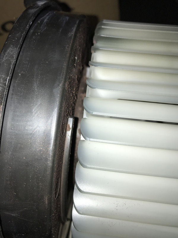

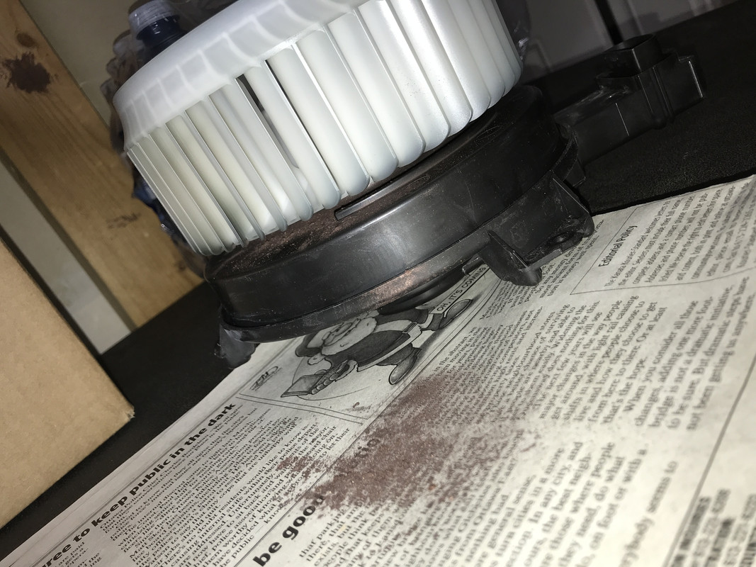

If people want to check yours it's easy and takes 10 mins if that, here's how;
- remove cover, pull down near the 3 pull clips then remove the bulb and wire by turning top down towards you.
- remove blower, unplug wire hardness big white clip and wire clip to give more slack, support blower with hand and remove 3 screws, use socket 8mm is easiest.
Now to check if your blower has built up dust shavings inside, tilt sideways and lightly tap on counter, either some will fallout or at least you can view inside the space where the white fan blades and the motor housing is. also you'll smell a faint burnt smell. good luck
As I said this is my 3rd time replacing this; so that means the original 1 failed, plus 2 replacements now, and they all did the same thing. Had the car on the road since June of 2015

I only have 15k miles and don't use the blower much, but it looks like they need a softer/higher lubricity material for the brushes.

15,000 miles = about 25,000 kms, not even close yet but I'm sure it's starting, and yes correct, they need to do a re-design, Honda is still actively using this on their new 2019 models too.

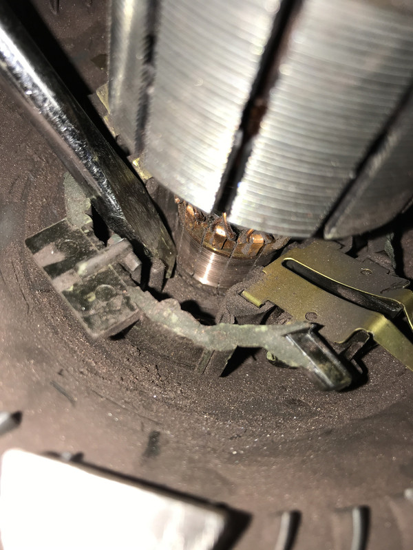

as you can see with my screw driver I'm pointing to the deep grove and the lip worn in from the brushes
It's crazy how much shorter these brushes are compared to new ones.
this is what we are breathing in guys over time, can't be good, I can smell it getting worst and worst over time, same pattern after replacing. We see what Honda has to say about this!!!

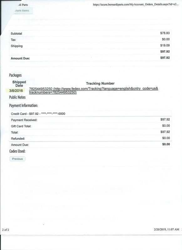

so the dates of buying the blowers are as followed;
- bought the car and on the road June 2015
- replacement 3/8/2016
- replacement 3/7/2017
- replacement again now in 2/19/2019
