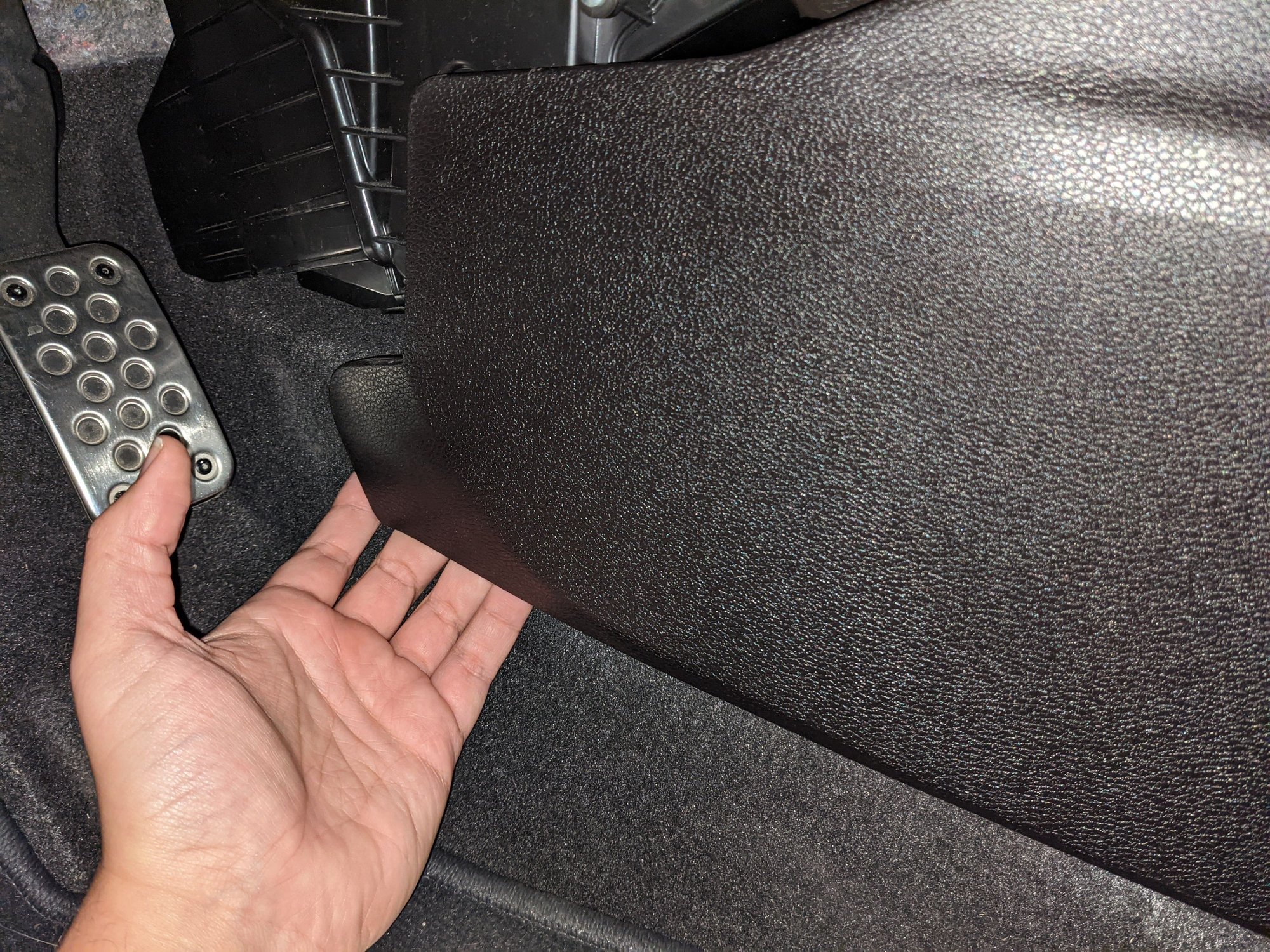

First, place your hand as so and pop up just this corner to loosen this panel.

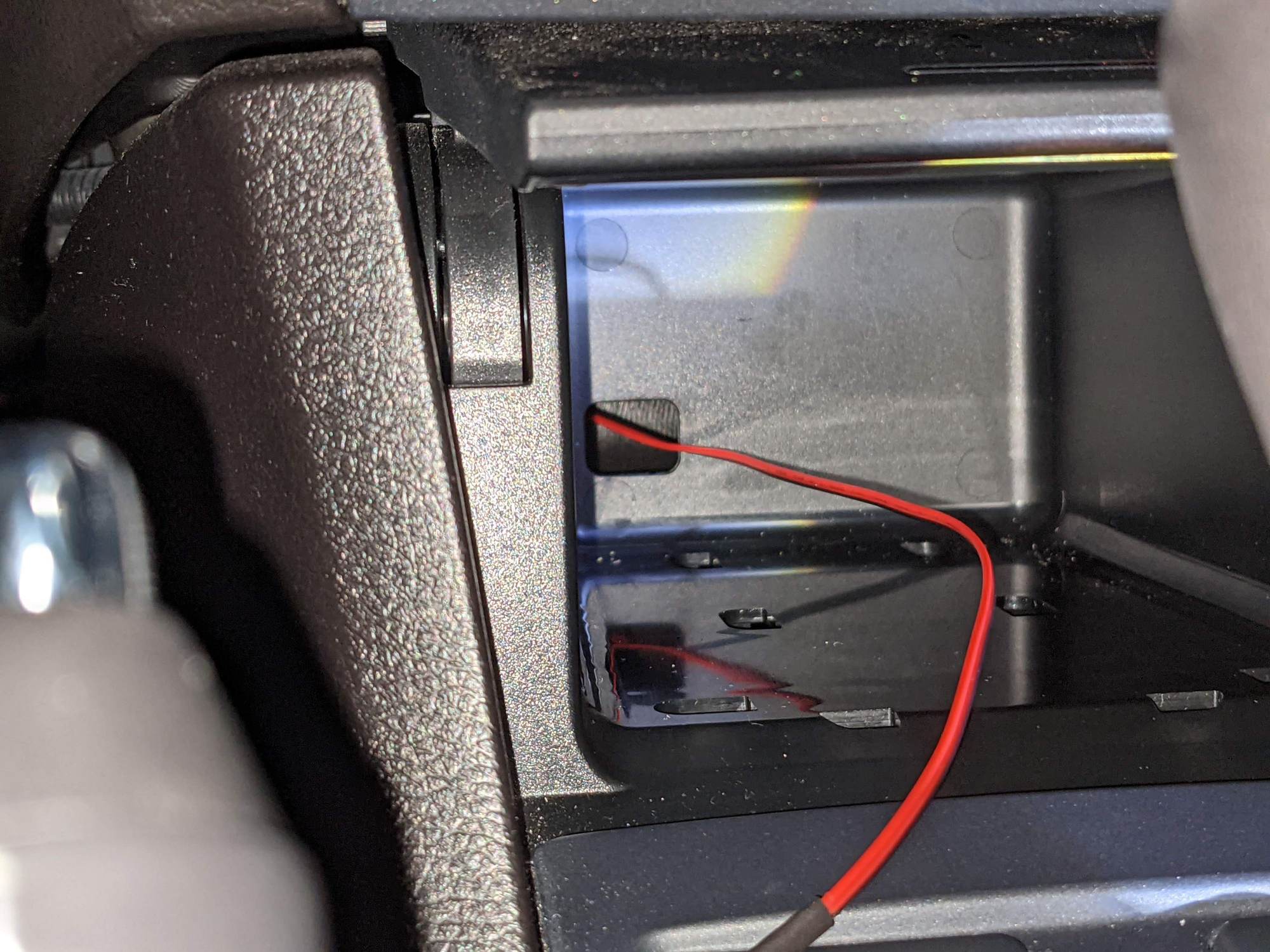

Take out the pad on bottom of the cubby to reveal the hole in the back of the bin. Start feeding the wire through the hole and try your best to point the wire towards the panel you just popped loose.

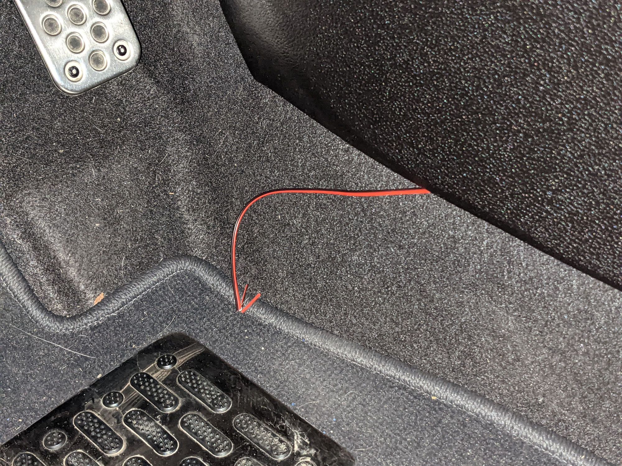

With any luck the wire will start coming out as shown here. if not run your hand along the bottom of this panel and you should be able to fish it out. if not simply start over and try again.

Thanks to the natural shape and rigidity of the wire assembly it stays nicely to the top of the cubby and now you have a light for it that will come on whenever you are in ACC or the engine is running.
