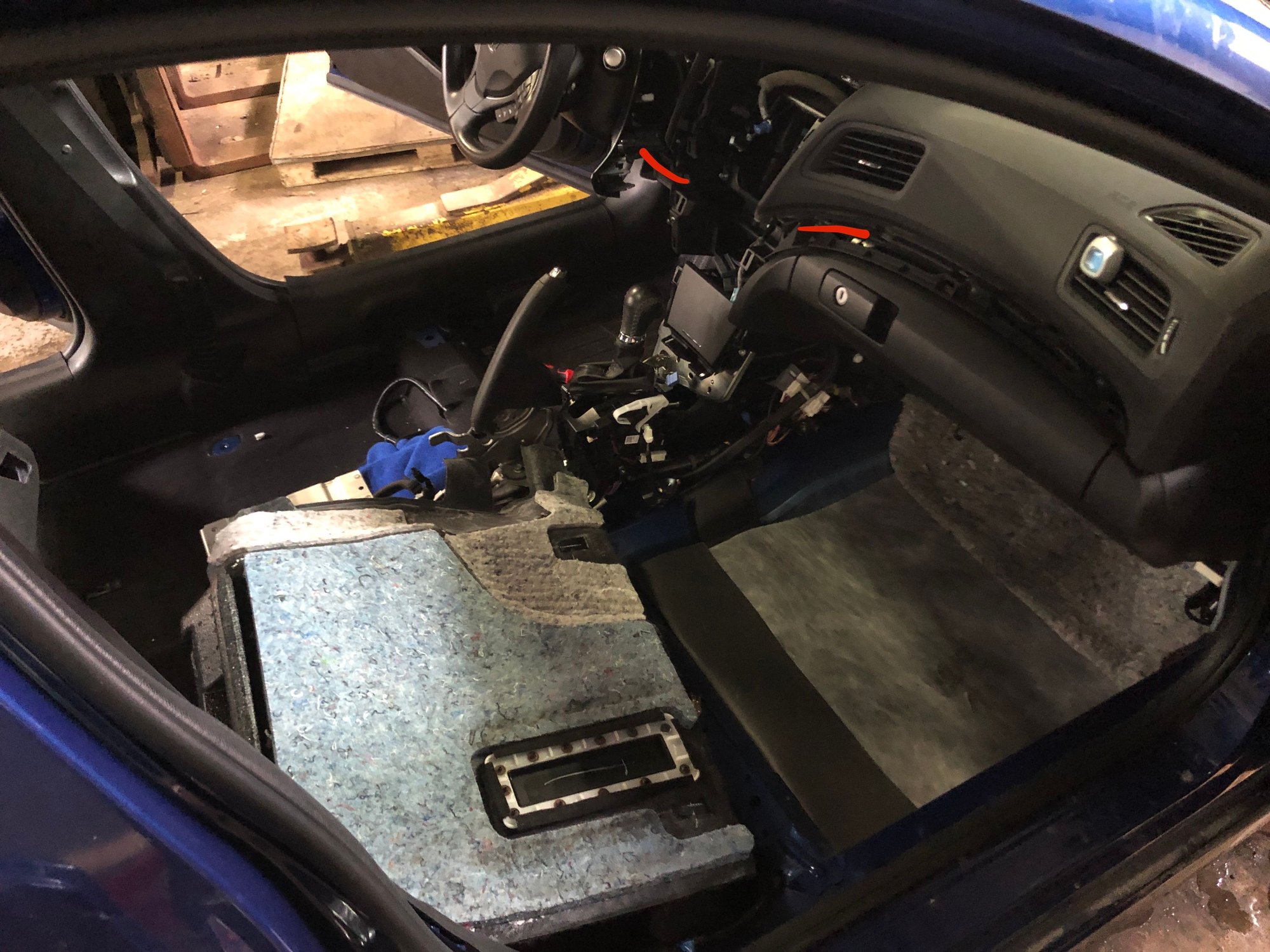

Hi, how do I remove this front cubby storage area? (generic picture) 2015 ilx

I do not remember per se, but I have picture, that shows the panels you need to remove to get there.
You will need to remove the radio and AC modules too I think.
Hope that it helps.

i have my a/c and radio removed but not sure how to get the shift knob panel where the cup holders are to be removed.

That is pretty easy actually. It is just clips holding it once you remove the silver trim around the shift knob.
Here is a video that helped me.

Hahah yeah , but the information is about right. Basically, you just have to remove the silver trim part, with a trim removal tool.
Once that is out, you just have to do the same thing for the whole trim, it is held by clips. Be mindful of the seat heater cable.

so the pic u posted what did u do that made u rip out that much stuff?

A little sound-deadening project that I did.
