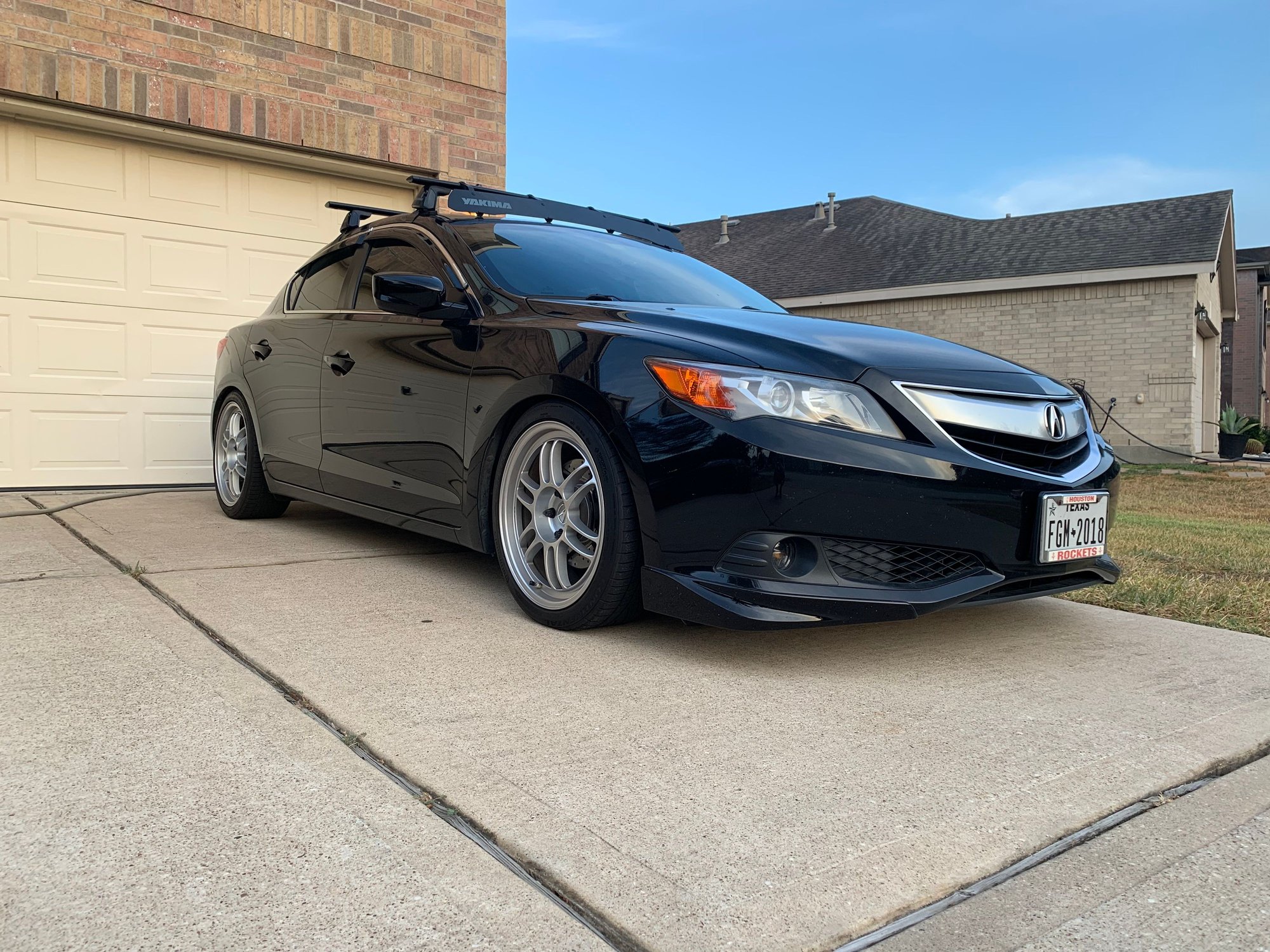

My 2015 ILX transitions lol
After I just dropped it on eibach prokit with stock wheels

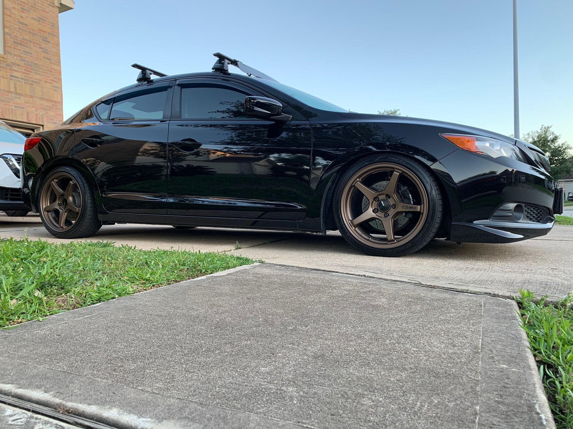

18x8.5 +35 AV06 225/40/18
18x8 +35 RPF1 225/40/18
(Current setup) 18x8.5 +38 TS5 225/40/18
Pretty flush. I had 4 in here about a month ago with luggage and it didn’t rub once!!

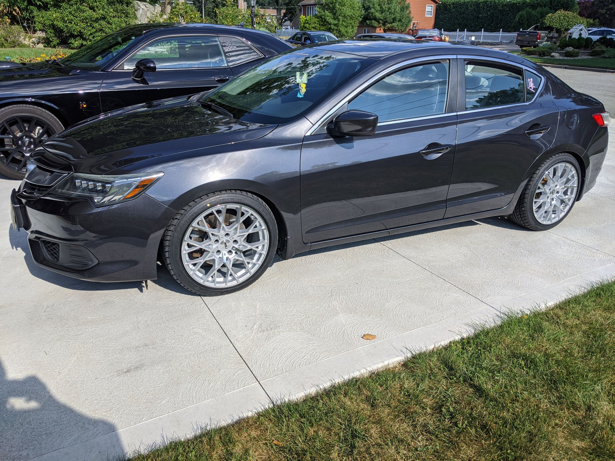

Originally Posted by bmassssy
These are TSW Sebring 18x8.5+30 square, 235/40/18 lowered on H&R 51891 (civic si springs). Front rubs rarely but I'll prob just roll em. Finger gap in front and 1.5 finger in rear.
Not sure why only 1 photo uploaded lol.
