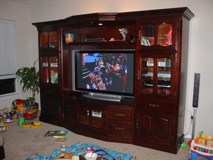

Anyone know of a way to cool down electronic that are enclosed in a entertainment center?
I have an entertainment center and the xbox360 plus the Sat reciever get very hot and overheat.
I can not leave it open because I have a toddler that could hit his head or pinch a finger.
Any advice?
