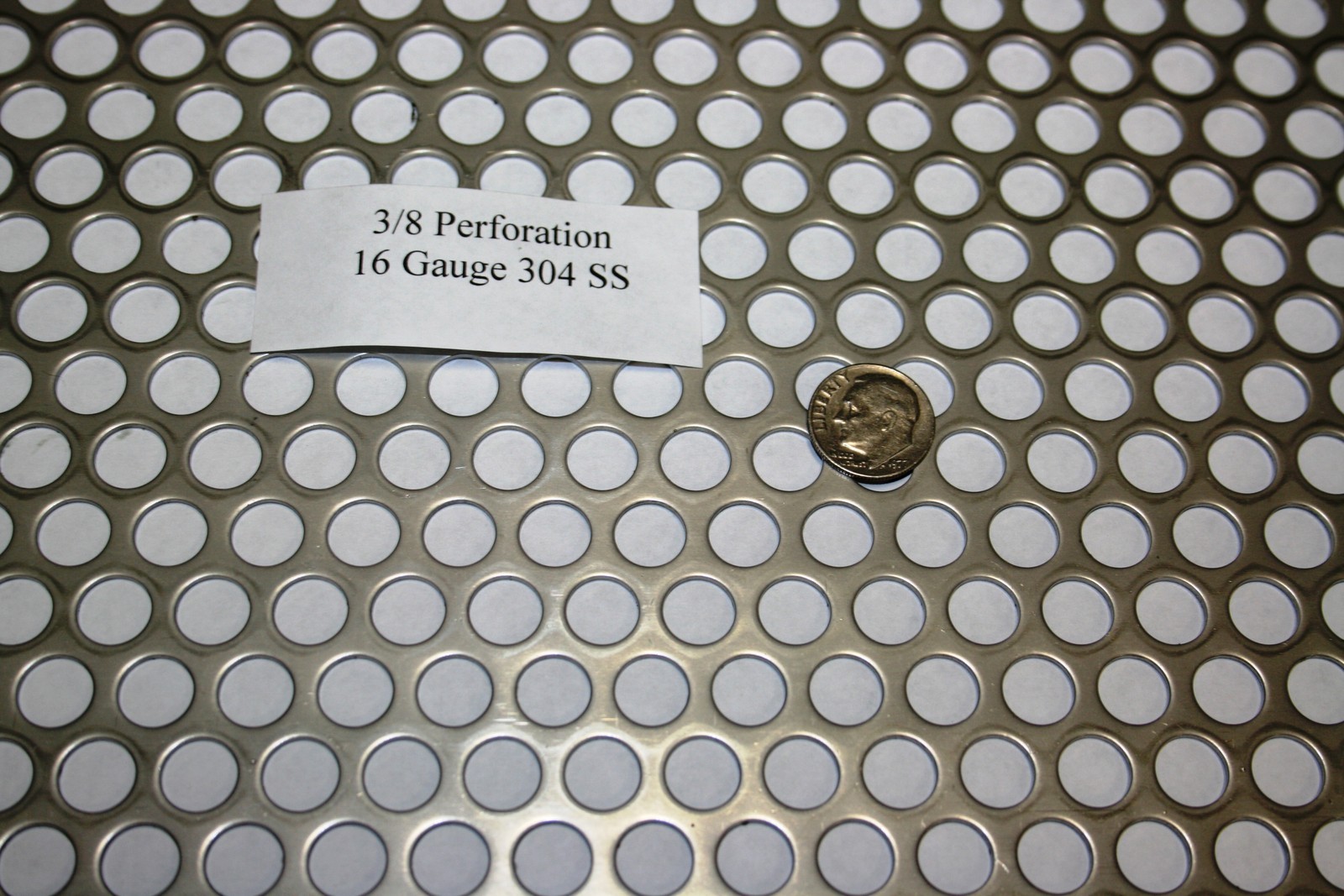

Still trying to figure out the grills. Down to between these two designs. I might have to end up going custom cause I can't find a grill in a 4x6 size to fit the rear that matches what ever I put on the side and I don't want a mismatch look even if the back is rarely seen.
Opinions on these two patterns. I like the Vogue but think it might be to modern looking.
The next question is opinion on stainless steel to match the drip tray and taps or oil rubbed bronze which seems to be more just like a dark brown powder coat and might blend with the wood finish. Maybe even just black to blend in. Leaning towards stainless but it an extra 30% markup.
Still have not purchased vent covers for this project yet because I am having a hard time convincing myself to spend close to $200 on some stainlesss vents although they will look really good.
I thought of another option. I recently picked up a router on sale at Sears since they are still giving away tools. I bought it for the purpose of making picture frames myself rather than buying them as I need some larger frames that normally cost a good amount. Now I am thinking maybe I could use the picture frame concept and just get some perforated stainless steel and inset it in a wood frame and make those my vent covers.
Something like this
https://www.ebay.com/itm/3-8-inch-ho...MAAMXQhuVRPlIM
Only thing that has me hesistant is that it would possibly not look as finished as those other ones.

I know you want a very high end look and while I agree it looks good, have you checked out Lowes? They have 2x3 foot aluminum sheets that you can cut down, not sure if it's thick enough but I would think it would work.
Edit - Re read your last post and it appears you're on it, I would do that personally.
Oh, $32, just a thought.
