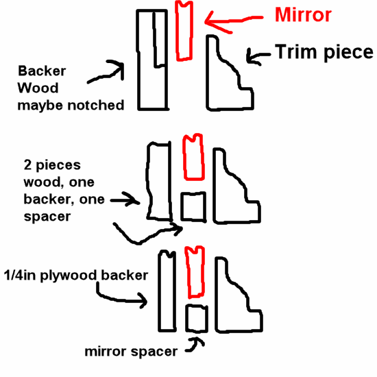

You should be able to use door trim, tack it together in the corners, then put the mirror in the center. Then take another piece of wood and attach it to the back of the trim.
In this way you would have:
trim
glass
backer
Kinda like giving the trim an overhang on which the glass will rest.
trim
glass
backer
What are you suggesting for the backer? Mirrors get pretty heavy - that's why I want to mount it to the wall.
I'm only suggesting a piece of wood that it only an inch or so wider then the molding/trim you want to use, to create a small lip. If you want something coving the entire back, 1/4in plywood.
How about this:
