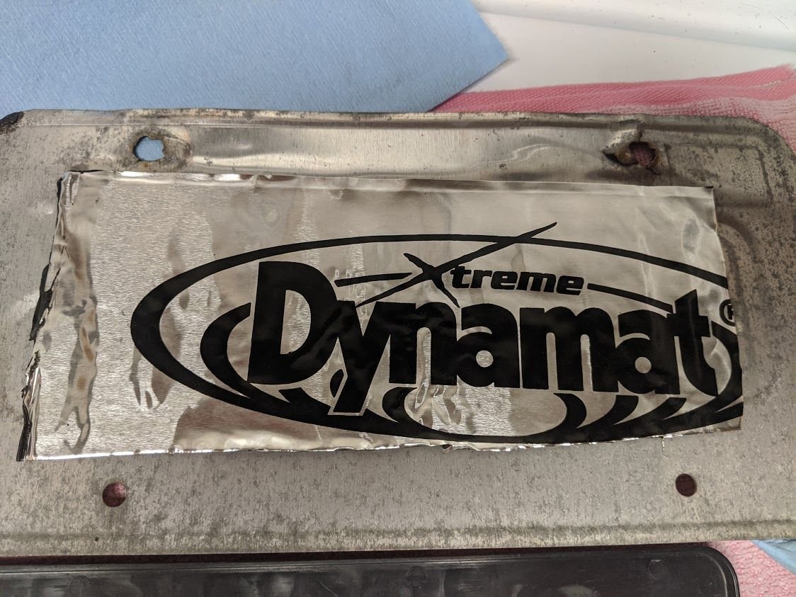

Small little update, waiting for better weather to paint, and weather is not cooperating whatsoever. The stock license plate screws were RUSTY, yes RUSTY! And they were rusting all over my license plate, so I had to do something about it. Here's the stock screws
Since I had the plate off I cleaned all the rust smears, and also did a small mod that I have on my Ack that I've always wanted to do to this plate and threw a strip of Dynomat on it. I don't have any rattles with the plate, even with the sub, but when I shut the tailgate I do get a bit of vibration so I figured I'd throw some on.
Here are the new black anodized screws that I used, much better and no more rust

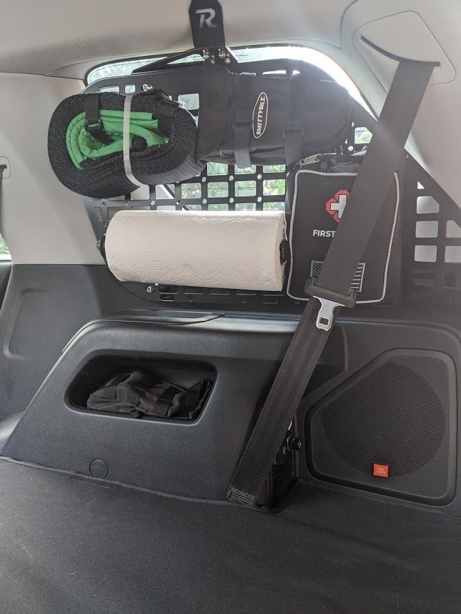

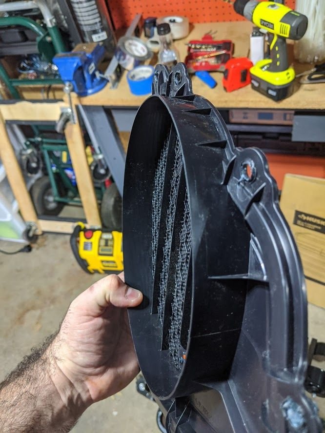

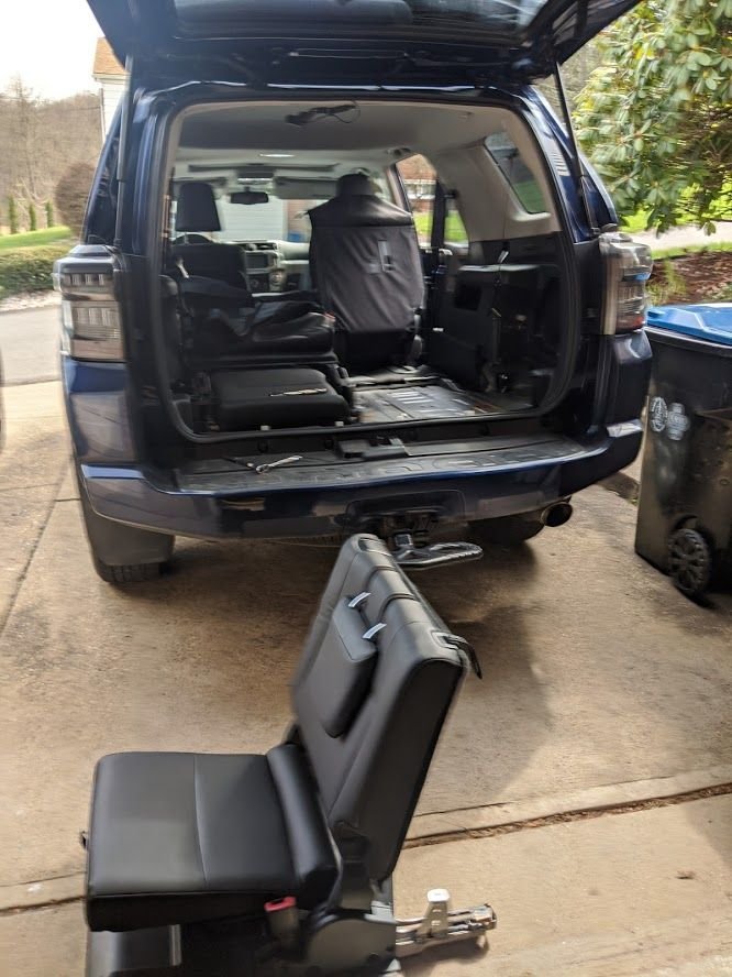

Small update, but a LOT of work to get it done. After about 2 years of searching I finally was able to source the stock JBL speaker cover for my retrofitted JL sub that I installed a year and a half ago. It's been sitting in my office for months waiting for me to get a warm day to rip the whole back out of my truck. I started out yesterday removing the rear deck lid, the third row seat and all the trim panels. Here's a little before, I am still loving the hell out of the new tail lights!
And here is after I removed the third row seat, in order to get to the screws holding in the trim panel.
And here's a quick before of the JL speaker and how I've been rocking it for the last year and a half. Excuse the seat belt hanging in the middle I already unbolted it.
And here at long last is the stock panel, this is a before. This piece cannot be ordered separately (I had the same issue with my 4th gen speaker panel. The whole panel piece is $700 and you have to order the whole side not just this piece)
Probably overkill, but I wanted to trim all the excess plastic ring to ensure that it wouldn't touch or mess with my JL speaker.
And here's an after with all the trim cut out
And here's the ring and all the plastic that I removed
I had to drill out and widen the holes in the trim piece in order for it to sit flush (no big deal and was expected). After I got it sitting flush I took some RTV Silicone and glued all the holes. I was going to use superglue but I figured silicone would be easier to remove if/when I ever go back to stock and reinstall the pocket that goes there. I used some 5 lb weights to hold the panel on it's mounts.
I had originally intended to Dynamat the back side of this panel, but once I saw how rigid it was and how difficult it would be I decided against it. I have zero rattles with this setup so it just seemed like overkill.

Most of the silicone dried within the first hour, but a couple still weren't dry so I ended up pulling the truck into the garage overnight and putting the panel on the trunk of the Acura with the weights to let it dry and cure overnight. Here is the finished product today. The silicone held up super well and the panel does not flex or move whatsoever, I'm very happy with the outcome.
And here is the first test fit with the new trim piece. I was able to stick my hand up underneath and make sure that there were no clearance issues with the sub, and even with the JL dust cap grille cover that I had on, so I decided to leave it as an extra layer of protection.
And here's a wider look at the test fit. I was fighting glare the entire time, so I did my best.
And here's the panel all installed and ready for the third row seat to be put back in.
And here's the final result once the seat and all the trim panels are back in place.
And a wider shot, trying to avoid the sun glare.
And here's with the CanvasBack liners reinstalled.
And the storage panel remounted and installed.
I'm really happy with the look and I feel like it completes the interior and the back of the truck. I didn't mind the speaker being exposed because with the grille cover it almost looked like it belonged there, but this is SO much cleaner. I hate that it has the orange JBL logo on it, but my rear Husky Trunk liner actually covers that, bonus!

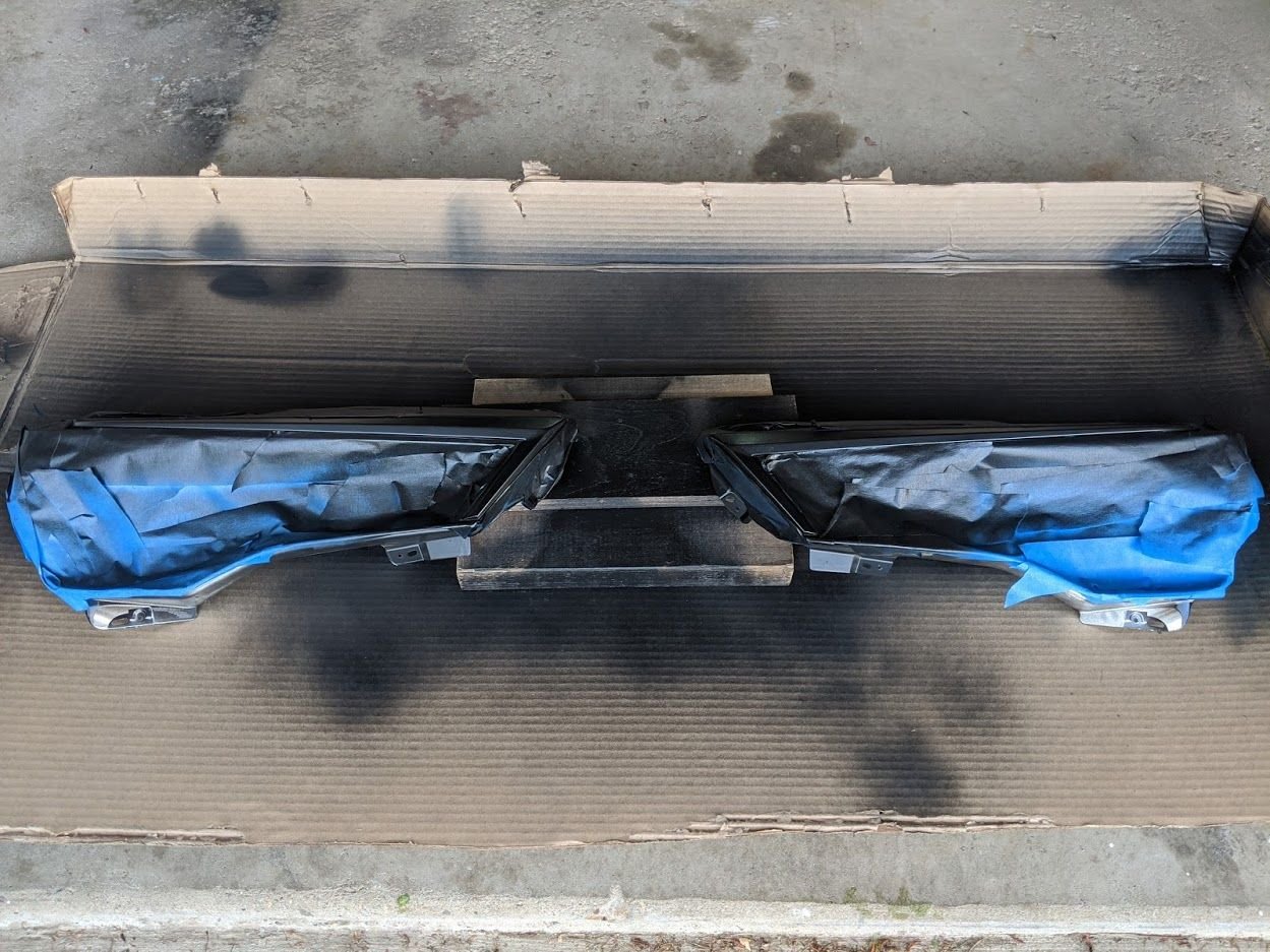

Finally got a good weather day, can't wait to finish this project...
