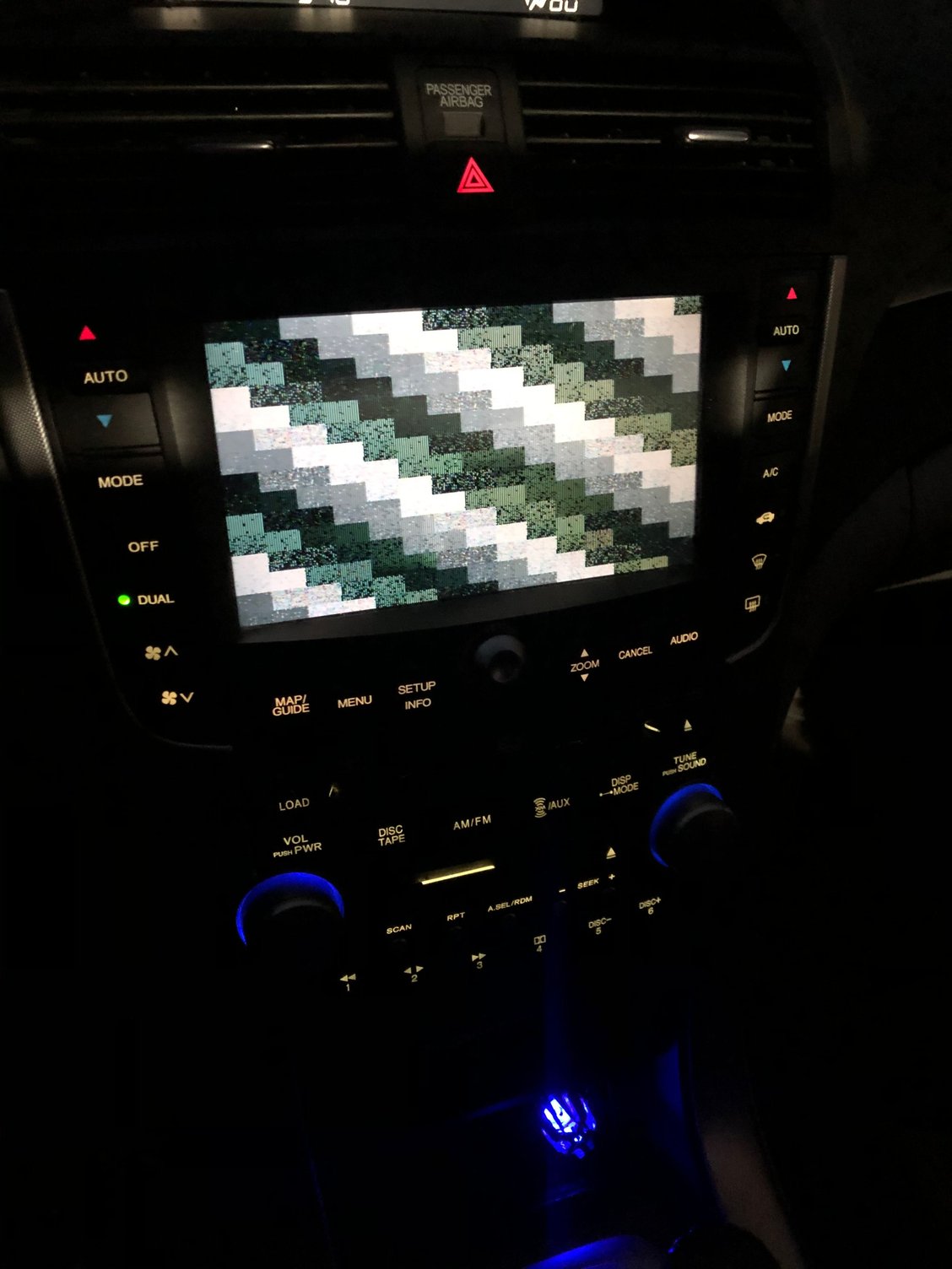

Anybody have any insight on what is causing this? Easy fix? Screen going out? Loose wire? If I start the car and put it on reverse the back up camera comes on sometimes and stays on reverse view once I put it on drive.

Sounds like to me one of your harnesses connected to your Navigation drive going bad. I would wiggle each of them as you look through the rear glass to see which one is going bad . If none , possibly the rom is glitched which you might want to unplug your battery for 30 mins and to refresh it . Remember to have your navigation code and radio code in hand .

Get it fix?? Now I got the same thing on my screen
