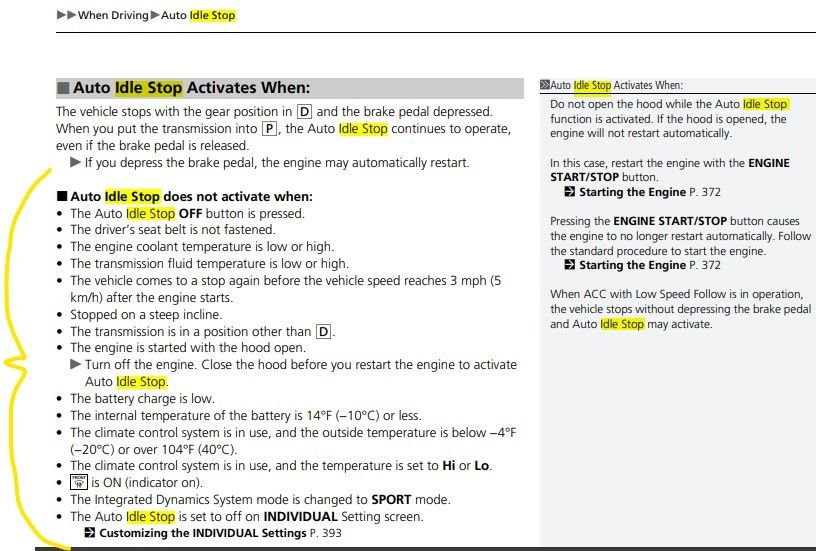

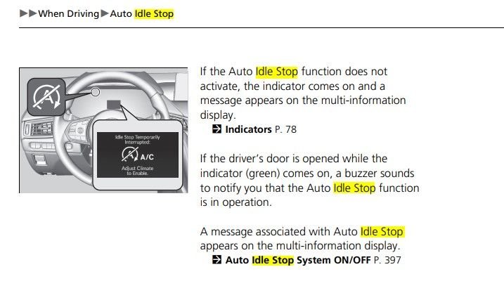

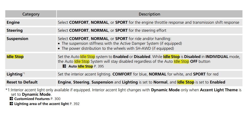

The Owners manual has some good information, I'm thinking these guys referenced the OM to try and understand what the 'Idle Stop' particulars are?
If you look at the last picture there appears to be some ATF, battery & coolant 'temperature' related factors going on?
Maybe you can tie this into your individual experiences, somehow to see if that is the culprit?
