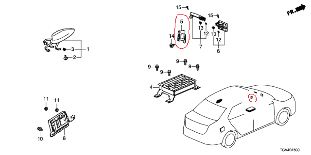

Some Googling of Acura TCU found articles referencing the TCU as the "Telematics Control Unit" as well as the "Transmission Control Unit". Based on what I've seen in the fuse diagrams and the results on Google, I suspect that the fuses may be a mix of both. I am guessing that the driver's foot-well fuse is probably the telematics fuse, based on the fact that acurapartswarehouse.com diagrams show the telematics as being somewhere under the dash in the cabin and most of the other fuses in the drivers foot-well are for cabin based accessories such as heated seats. (https://www.acurapartswarehouse.com/...0-tgy-a21.html)
The engine bay fuse(s) are probably transmission. Any chance someone who owns one of these cars would be willing to pull one of them at a time, preferably starting with the fuse in the drivers foot-well and see what happens when you turn the ignition on? My thinking is to pull the drivers foot-well fuse first, turn on the ignition without starting the engine and see if the AcuraLink / cellular connection still shows a signal? Maybe even try to use the concierge call button on the roof near the moonroof buttons to see if you can call Acura without your cell phone blue-toothed to the car (that would use the cellular modem in the car).
As for any potential issues, putting the fuse back in should revert any potential check engine lights back to normal "off".
Alternatively, there are some basic diagrams on acurapartswarehouse.com suggesting where the telematics unit is located in the vehicle, which would allow some resourceful people to unplug / disconnect the unit from power or antenna but that looks to be a lot more work digging under dash panels and would be more permanent. Pulling fuses is an easily restoreable option for future sale of the car.

I recently did this for my 2015 TLX. I removed the TCU then tested that both the buttons near the center lights didn’t work. It also disabled bluetooth. I’m pretty sure the car can’t send our telemetry without the TCU since a new TCU is required to use 4g/5g. Here’s a useful link I found https://static.nhtsa.gov/odi/tsbs/2015/SB-10108380-9340.pdf
idk if the tcu is still there in the newer tlxs
