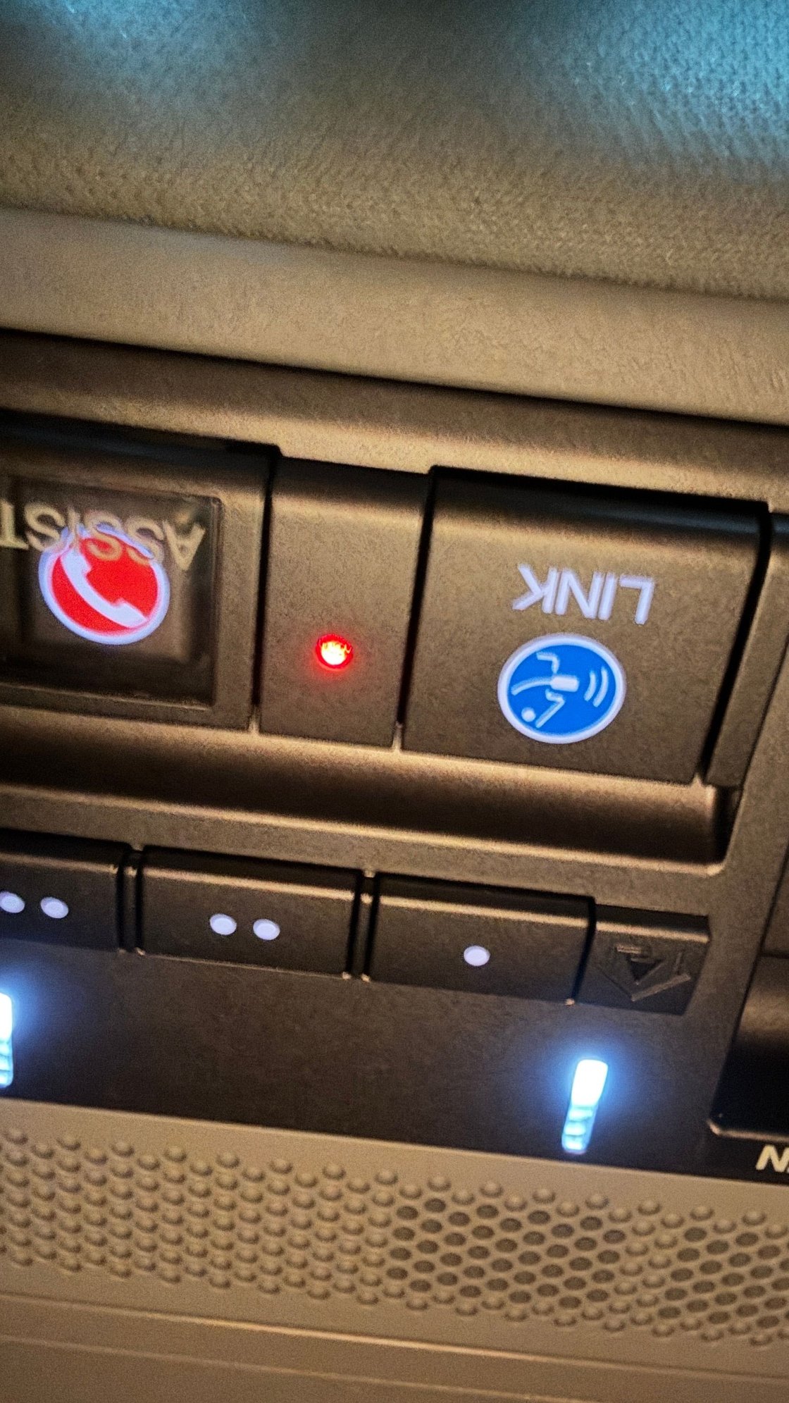

Red light overhead next to Acuralink
Hi guys,
Any idea what this could be?. Read on Reddit that it could be loss of comm for Nav. Also read the module can be reset by disconnecting the battery. Don’t wanna do that unless it is a last resort because I don’t wanna deal with radio codes etc. This started happening just last night.
2020 TLX Tech

Go below, TSB 19-016, last page.
https://acurazine.com/forums/5g-tlx-...letins-978089/

thanks - just to be clear - a TSB bulletin doesn’t mean it’s a free repair, correct?

No, I just linked to it because it is the only place that oficially publishes what the light means.
If you subscribe to Acuralink, call them up and they can help diagnose whatever is broken.
