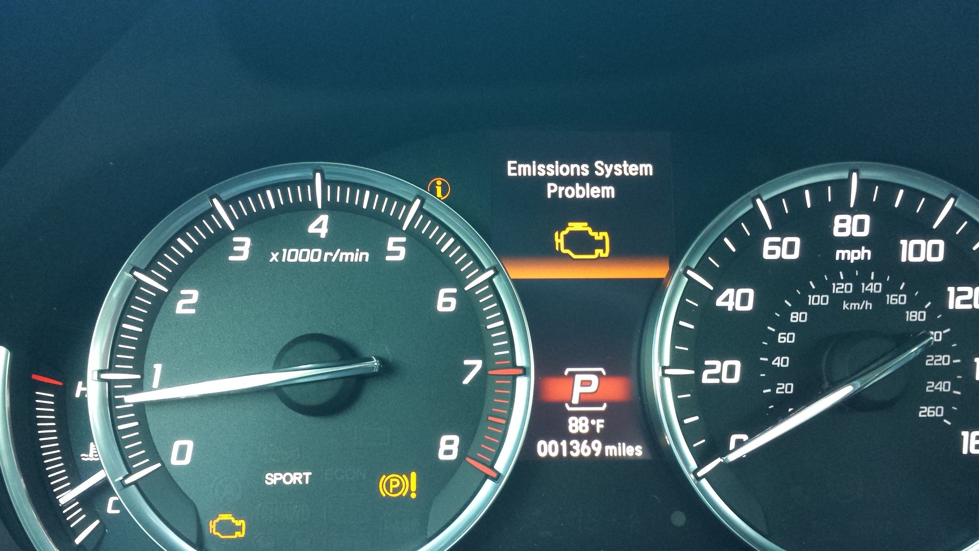

Bummer, I get the same indication but they cannot find the issue. First at 2 weeks of ownership and again at 4 weeks. I get Emissions failure and Electric Parking Brake Failure. They reset the indicator and it worked fine for two weeks. Good thing is I get a free car wash every two weeks.
Emission System Problem
Electric Parking brake problem.
