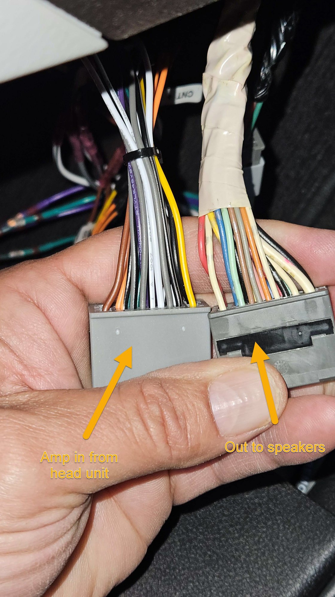

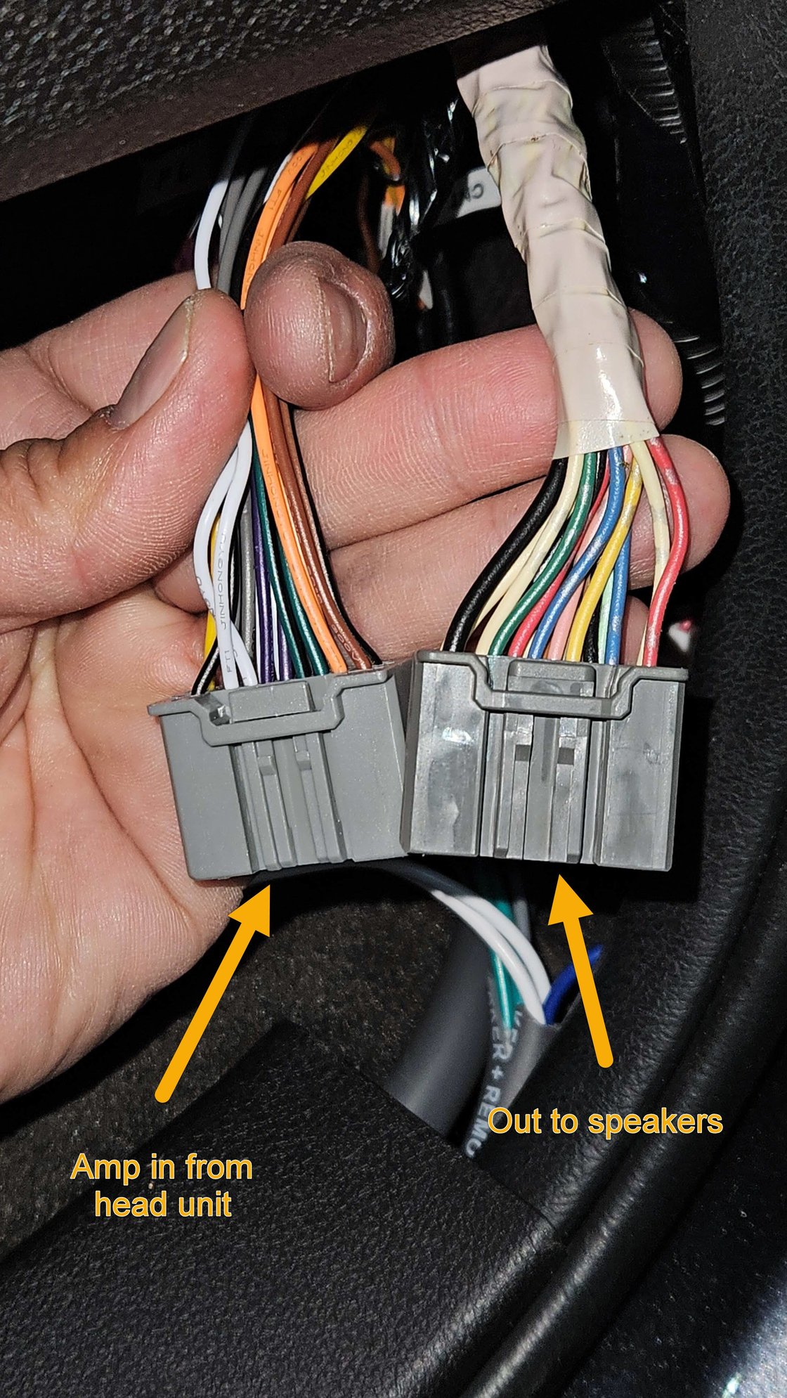

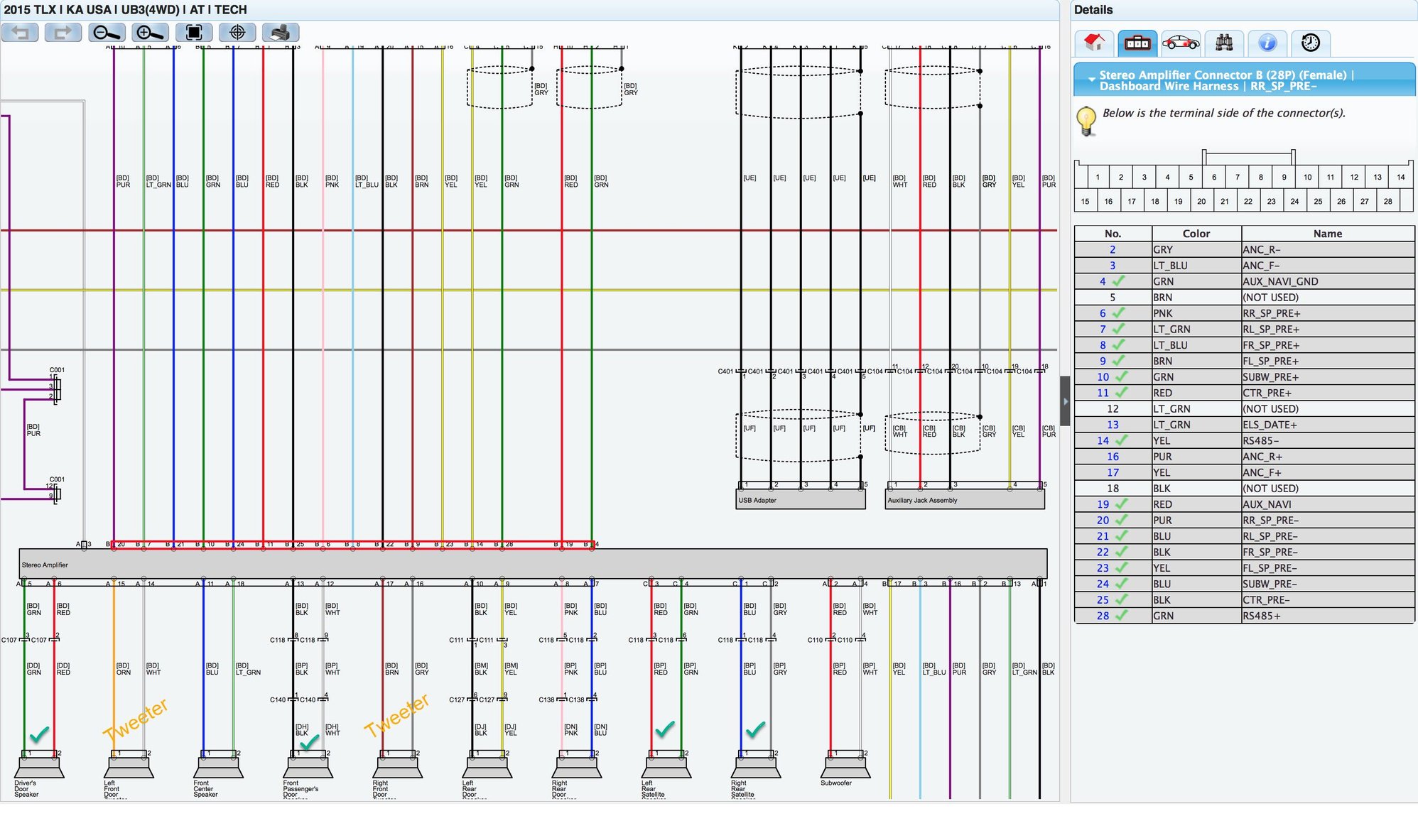

I have looked at wiring diagrams and I just don't see where the problem could be. Is the wiring diagram I used the wrong one? Am I missing something as far as using a common ground? I'm attaching what I used, along with a picture of my OEM amp connectors. I'd greatly appreciate any ideas.

If someone has access to the wiring diagrams, I'd really like to verity that the diagram that I used is the correct one. I have a 2015 Acura TLX, Advance package.
