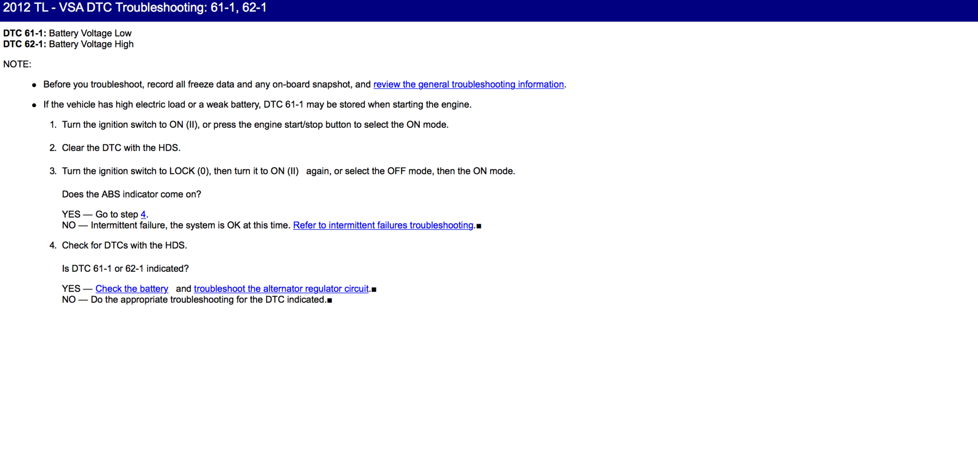

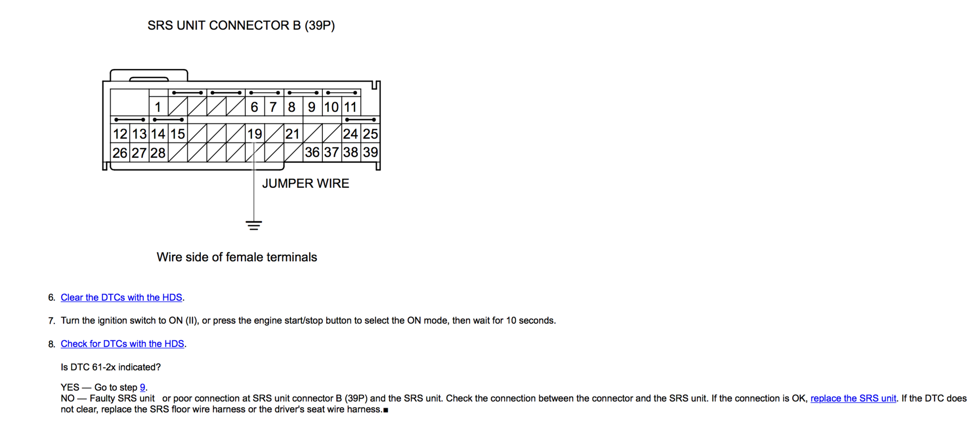

Old Jun 6, 2015 | 12:15 PM
spakhnyuk's Avatar
Joined: May 2010
Posts: 36
Likes: 10
From: Bellingham, WA
