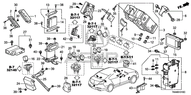

I MAY be wrong and hopefully another expert can chime in but I beleve it's this unit: 2672695-STX-A01
BUZZER ASSY., KEYLESS
OEM Acura TL SEDAN 2009 CONTROL UNIT (CABIN) (1) parts

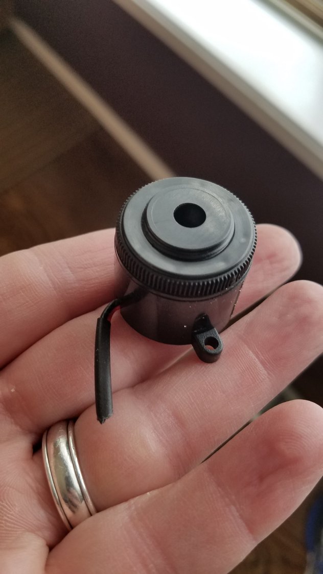

Problem solved. @CSMEANCE and @JUSTNSPACE were spot-on.
I had to take the car to the dealer for recall work on the drivers airbag and asked them to look into the source of the noise. I made the service rep sit in the car and start the car. I should have shot video - he too was appalled. The tech found what it was, and it was an aftermarket add-on.
Apparently my car was previously owned by the lucky recipient of multiple DUIs. It was a decommissioned breathalyzer ignition control system. The alarm that sounded when the system failed to detect the control and recording unit was not decommissioned at the time that the system was shut off. I found the speaker, said a quick prayer that I wasn't going to cut off the ignition to my car and cut. Everything works perfectly now, even the original soft start chimes are back!

Here is a picture of the little bastard.
