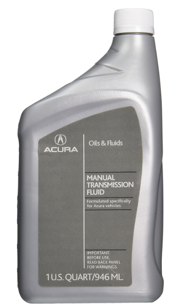

Old Jul 30, 2024 | 08:50 PM
Posts: 6,921
Likes: 2,214
Originally Posted by mvl
I don't recall ever getting parts that say "Acura" on them. Everything I remember (even from an Acura dealer's parts counter), said Honda on the package. Only exception I can think of is that their touch up paint said "Acura".
Now that I think of it, I can't recall parts with the Acura name, though, I've received these over the years:
Old Jul 30, 2024 | 09:34 PM
619rcr's Avatar
Joined: Jul 2019
Posts: 1,188
Likes: 670
From: AZ
Agree, with exception of fluids, a few things I recall ordering which came with Honda labels: CL Type S engine block, NSX shift knobs, TL shifter and shift cables, MDX tow hitch kit.
