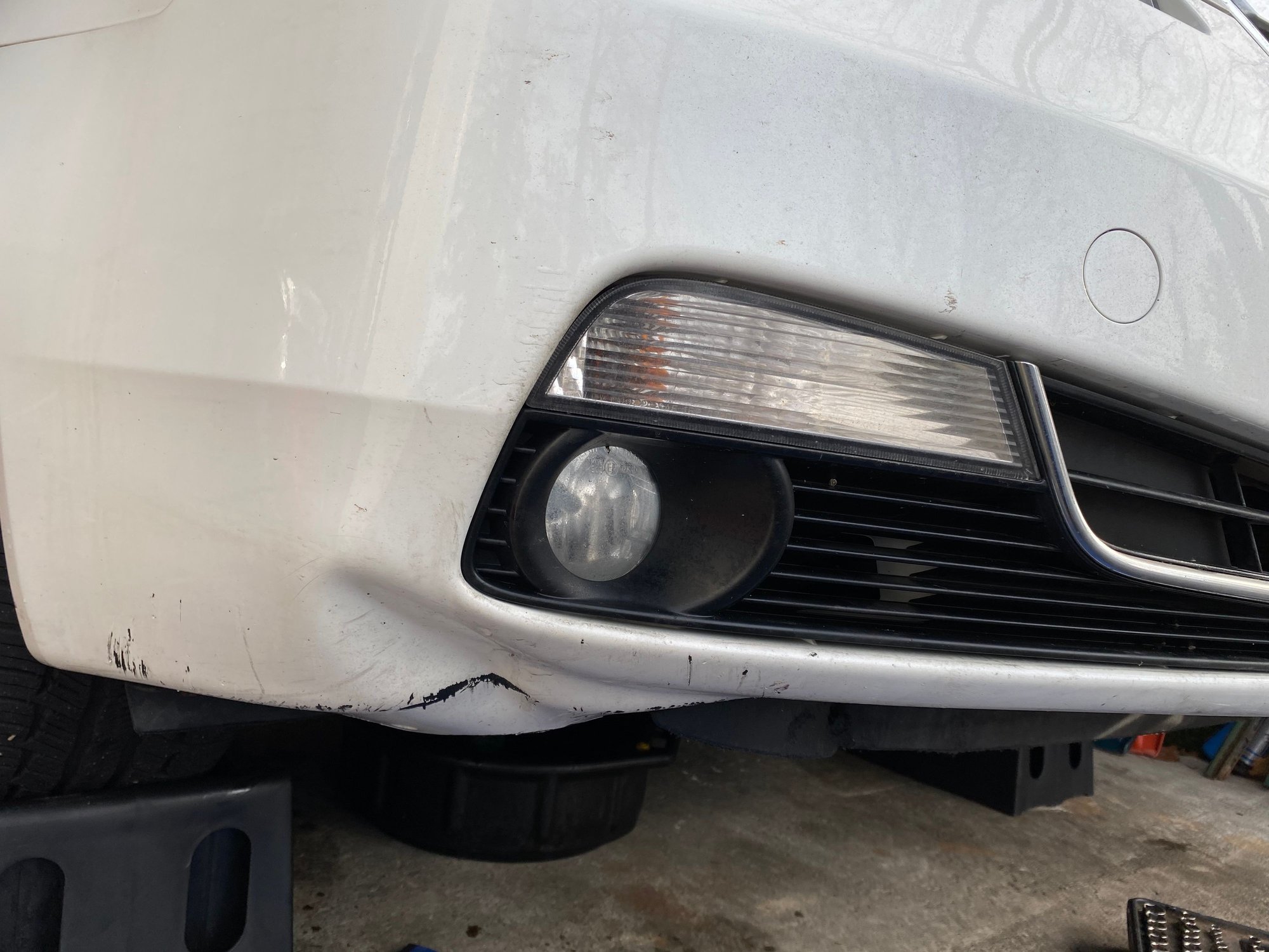

Hi,
How would you repair this?
I do have a paint less dent remover kit.
Though this is not metal surface so I am not sure.
I can always remove the dented piece out and tap it out...
That would take some work and I will probably do in sprint time.
Thanks
Robert

I would heat it up a little and pop it back into shape.

Look at the boiling water method to pop that out, it should come out fairly easily.

Thank you,
I will give it a try.
