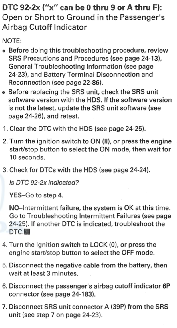

Airbag light came on? 92-2..anyone tackle this before? Thanks guys

This is what my book has for 92-2 code, hope it helps
thank you so much will take this on tomorrow
