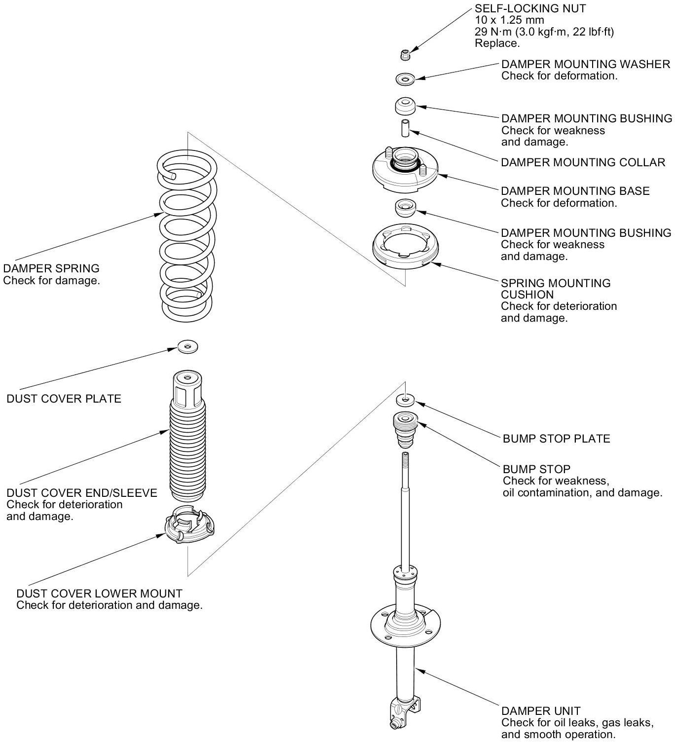

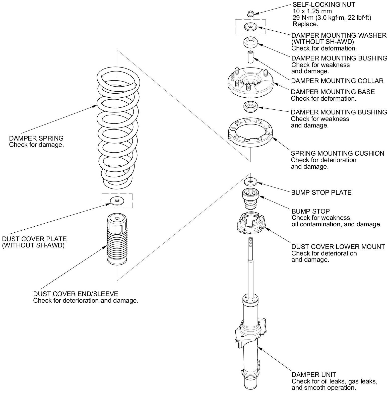

When it comes time to put them all together, here is the assembly order for the front & rears.
Good Luck!
Front Damper/Spring Disassembly, Inspection, and Reassembly
Exploded View
Rear Damper/Spring Disassembly, Inspection, and Reassembly
Exploded View

Thank you so much!! You're a godsend!
