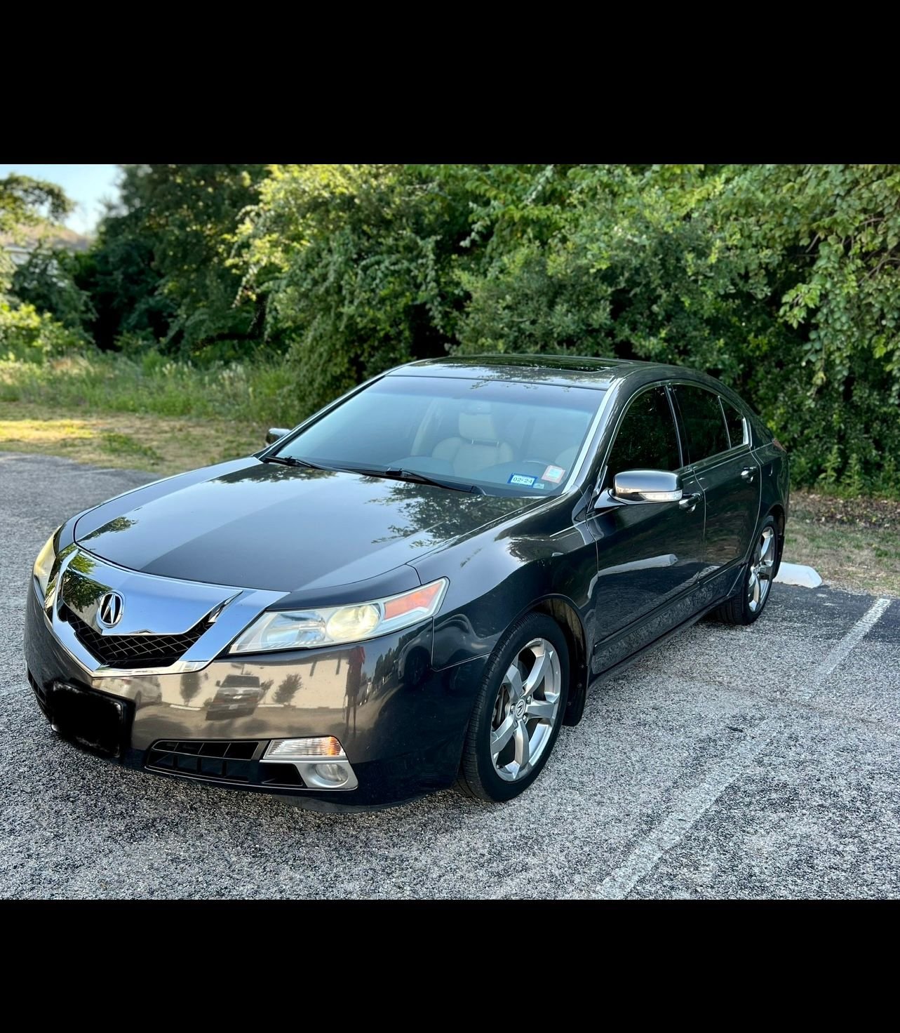

Hi y’all. So I’m new to the Acura community. Owned this car for a few weeks and I love it. Compared to the only other car i’ve driven, a 2011 Kia Sportage, this is a blast. I really want to modify the car, the right way and I could use some suggestions. I’m new to modding so I really don’t know much. My main things that I want right now, are some cleaner headlights and taillights, some nicer rims, and a nice exhaust. Nothing loud and raspy, but I want some noise. A nice rumble. It’s a 2011 SH-AWD.
Any help or advice would be appreciated! God bless.

Headlights and taillights there really aren't any aftermarket options apart from custom work. If they are just faded you can restore them with wet sanding and a new clear coat. Many kits that you can buy to do this yourself.
Wheels maybe look for used 5x120 bolt pattern see what is out there. Otherwise of course it's up to you what you want to get new
Exhaust like brolando said you can start with a j pipe or for cheap you can replace your mufflers with magnaflow 11225(which is what I have) or borla mufflers etc. Probably don't delete the mufflers (may sound good but loud and drone) and if you want more expensive option they do sell catbacks which sound great.

thank you! I actually had my headlights cleaned today by my grandpa and they look great. I do wish I could find a better option. I’m not a big fan of the amber on the side. I was thinking about smoking the taillights but I’m unsure. I was also thinking in the future of lowering it once I get the rest of the car looking nicer. Not sure though.
