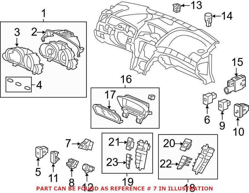

I need to replace the Hazard & Passenger Srs Indicator Switch Assembly in my wife's 2012 TL. Does anyone have tips on how to remove the center dash/vents to get at the switch? Seems like the wrong approach could easily do damage.

Anyone find an easy way to remove these, or the right tools? I searched Acuras tools and I can't see how they are supposed to work.

Sorry for the late reply. Thank you for the tips. I just got a new set of interior trim tools from Amazon. They come with the small metal radio removal tools. How exactly did you go about removing the hazard switch and the center vent? When I read that diagram, it looks like I'm supposed to stick the tool in between the vent blades, and I'm not sure how that could work. Also, there isnt much room to access the hazard switch tabs, so Im not sure how to get only it out.
At this point I tried a coat hanger as someone else had done, and it popped one tab in the center vents, but I cant get access to the upper or the side.
