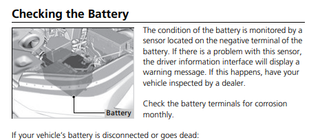

Looks to be under the hood according to the manual.
Old Apr 29, 2021 | 05:15 PM
Do you see it tucked in the lower right hand corner of the engine bay?
