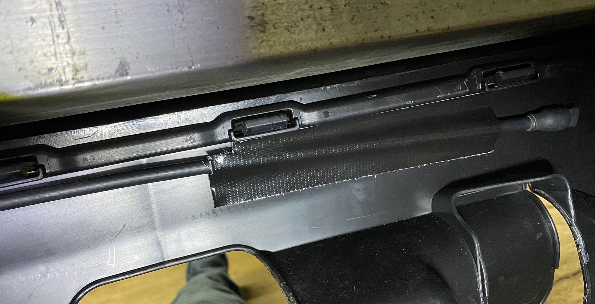

I should say right up front that the aftermarket Curt hitch does not play well with the factory installed hands free lift gate. I understand that Acura has a relocation kit for the sensor package to address the hitch issue but I have absolutely no use for the foot actuated hands free feature. If you need or want it, best to stay with the OEM setup. The factory OEM sensor package for the hands free lift gate does not allow sufficient clearance for the Curt hitch receiver behind the bumper. I am pretty sure that this is also the case with the OEM hitch, but I cannot state this with certainty. One of their accessory installation bulletins available elsewhere on this site seems to suggest a sensor relocation is required.
So on to the install. The Curt hitch is a pretty heavy piece of kit and is rated at 6000 lbs. This is far beyond my needs and also beyond the rated towing capacity of the MDX, even with the transmission cooler. It is the only one I could find. The shipping weight was 50 pounds so it would be great to have a helper to position the hitch for the install. I did it myself but only because I have no friends not because it is the best way.
The first thing that I did was put the vehicle rear wheels up on ramps so I had a little more room to work and I found the extra 7 inches of clearance gave me just about the right room to work from laying on my back. I disconnected the power as I knew that I would be messing with the wiring and I didn’t want any unpredictable reactions to my actions. I lowered the spare tire and moved it out of the way. I believe this is necessary and even if it isn’t, it sure makes moving the hitch into position a whole lot easier. Then I removed the hands free assembly from the bottom inside of the rear bumper. There were four sheet metal type screws and two pop out connectors holding it in place. Then I disconnected the control module and the sensor rods from the assembly. There was one screw holding the module in place and the rods just snapped into clips on the back of the panel.
I left all the wiring connected and tried not to put any stress on any connections. I used a tie wrap to secure the module to the top of the bumper frame member and reattached the sensor rods to the inside or the remaining panel at the bottom of the bumper.
To put the hitch into position, i used piece of thin rope to support the passenger side of the hitch assembly from the tailpipe hanger assembly. I left just enough slack to allow free movement at the driver’s side. Then I lifted the driver’s side into position and supported its weight on my bent knee while I started the first bolt to the frame. There are three bolts on each side and Curt says they need to be torqued to 135 lb-feet. That is a significant pull laying on your back under the vehicle, at my age. After the first bolt was installed I then installed one on the passenger side. Amazingly, all six bolts lined up to perfection. Torque everything up. Replace the spare tire and it is time to start with the trailer wiring. For another day. Oh yeah, forgot to reconnect the battery.
To my knowledge, if I or someone else decide to remove the hitch in the future, I have preserved all the electrical connections and the mounting assembly and it would only be a five minute job to restore the hands free lift gate to original.
The Curt Hitch extends under the rear bumper rather than through the bottom panel like the OEM does. This is actually a better height for my utility trailer and there is still lots of clearance.

Just for information. I installed a Curt hitch yesterday on my 2022 A-Spec. The Hands Free Gate still works. The panel itself that holds the sensor rods needs to be removed, trimmed in the middle where the hitch sits and re-installed. Trimming the middle section out still allows for all the panel fasteners and rods to be reconnected. The actual control box and wiring I wire tied to the hitch frame. The kick sensor works if I kick just beside the hitch receiver on the passenger side. I always found it worked better kicking there even before the hitch install.
Anyway, all that said, the answer is Yes it still works.

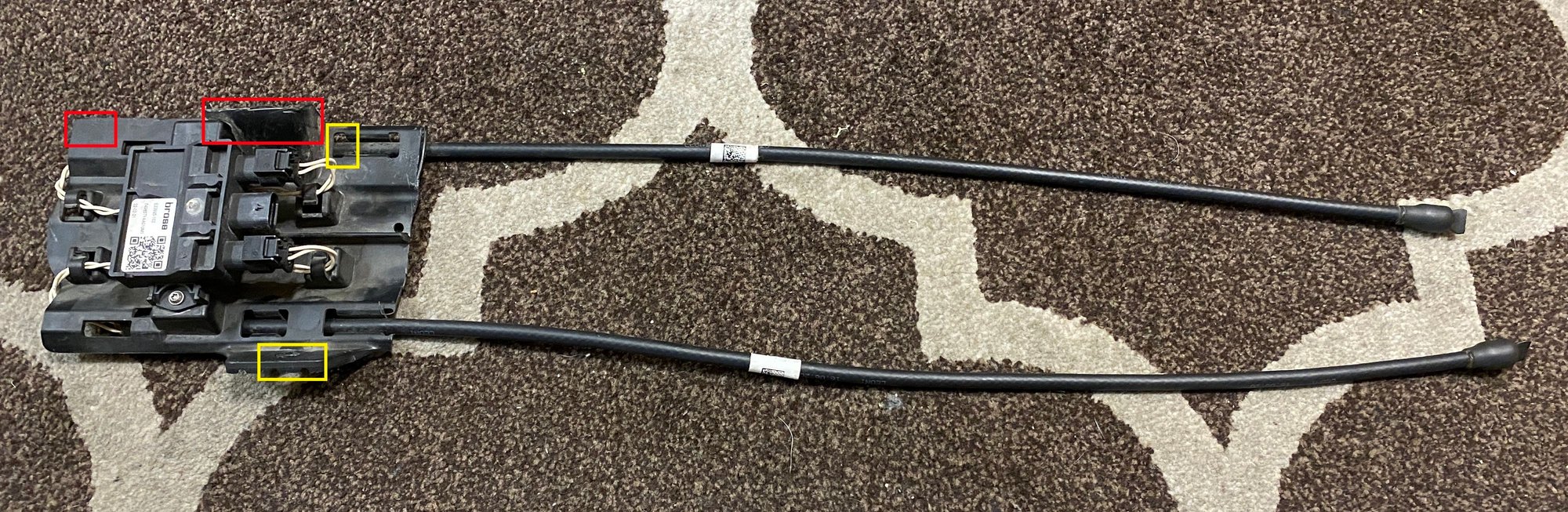

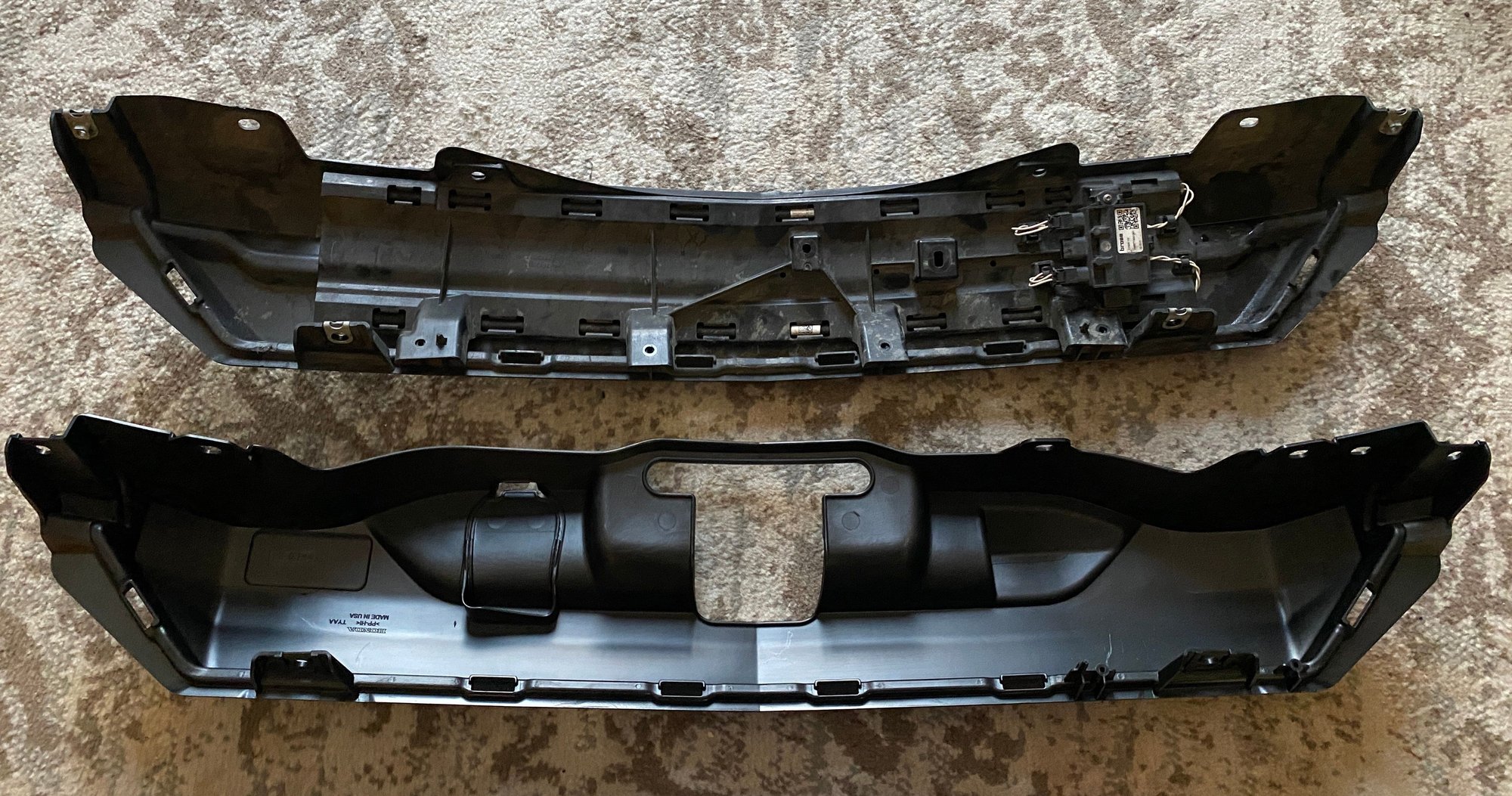

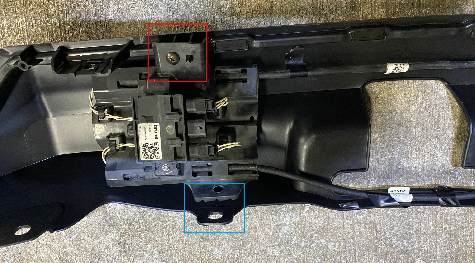

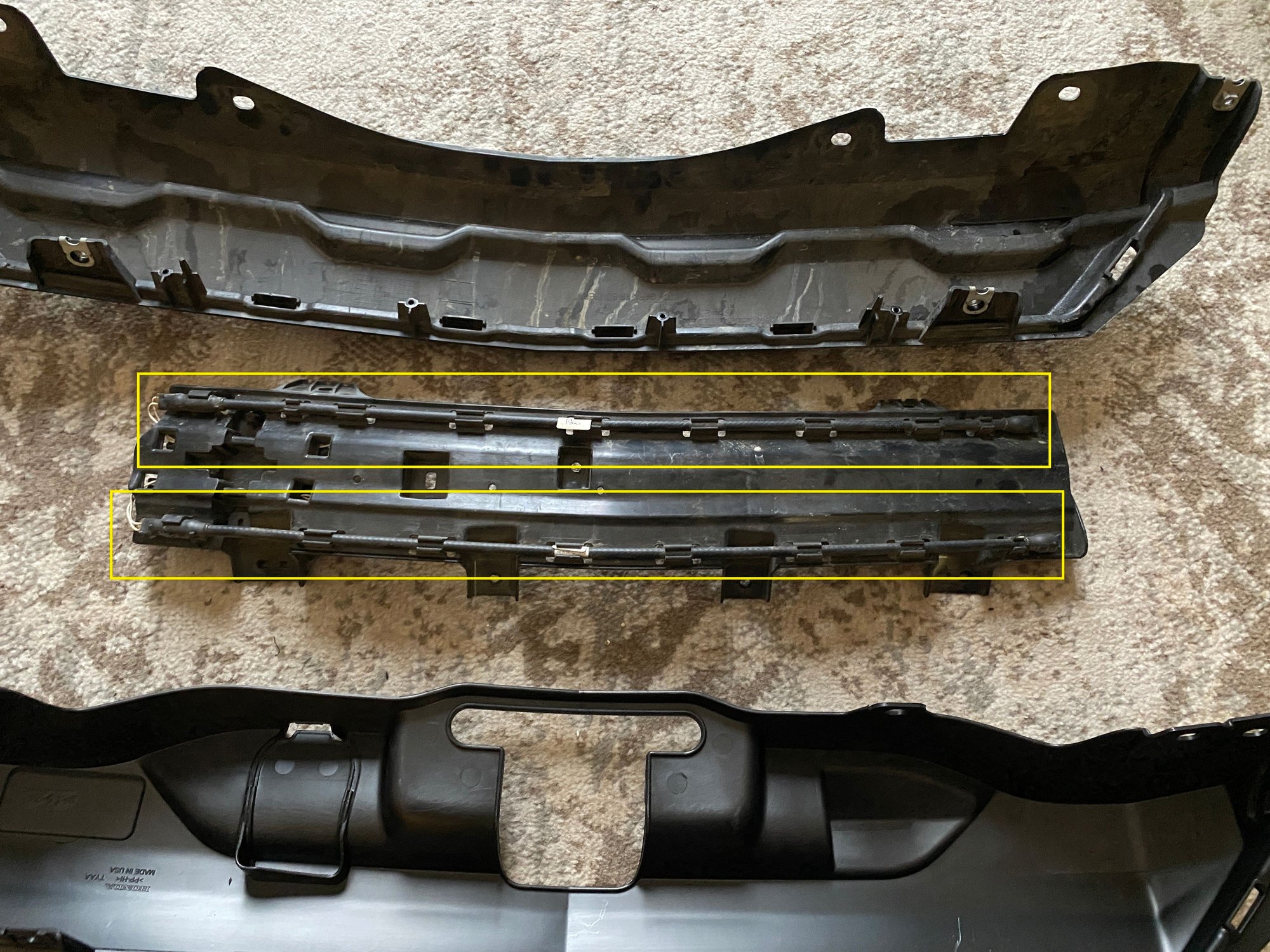

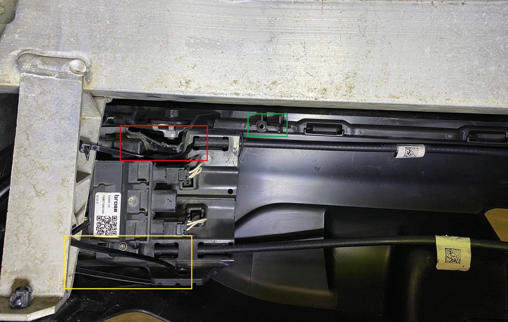

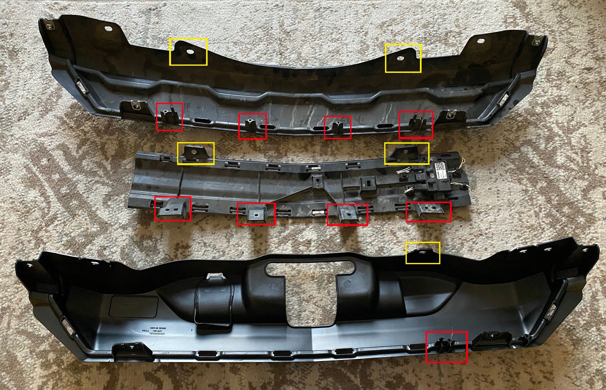

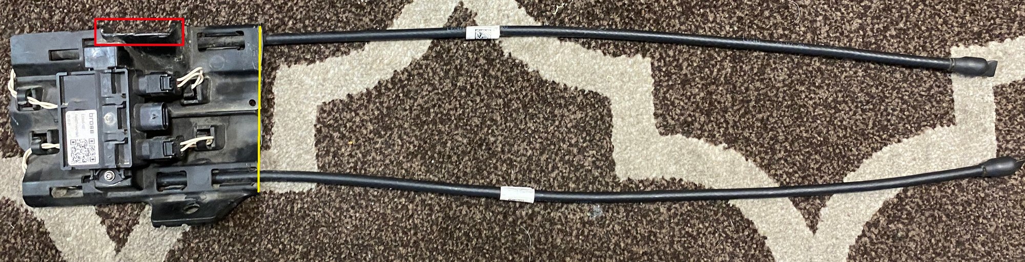

Can you tell me a bit more about "the panel itself that holds the sensor rods needs to be removed, trimmed in the middle where the hitch sits and re-installed." I am going to buy the CURT hitch and install on my 2022 MDX Tech pkg that has the hands free sensor.
Old Nov 17, 2024 | 11:19 PM
Cygnus_X1's Avatar
Joined: May 2012
Posts: 124
Likes: 27
If you watch this Youtube video, he shows how to remove the OEM Hands Free Sensor (HFS) from the original trim cover, cut out the opening for the ball mount, and then mount it on the new trim cover. starting at around 3:40.
For those of us that already have the HFS on our MDX's, this would negate the need to buy the (08L91-TYA-200B) HFA Sensor Kit, which is around $200.
This is assuming you use the OEM Acura parts and not a Curt or Draw-Tite hitch.
These are the OEM parts needed:
Part Numbers:
08L91-TYA-200 (Wiring Harness, 7-Pin)
08L92-TYA-200B (Trailer Hitch Cover)

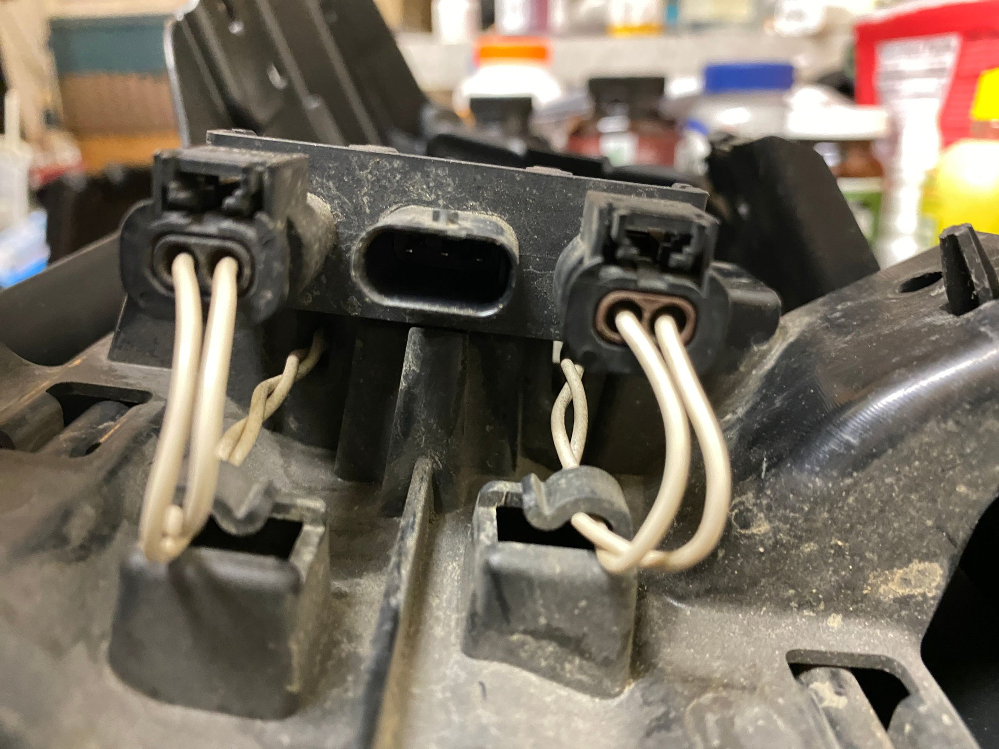

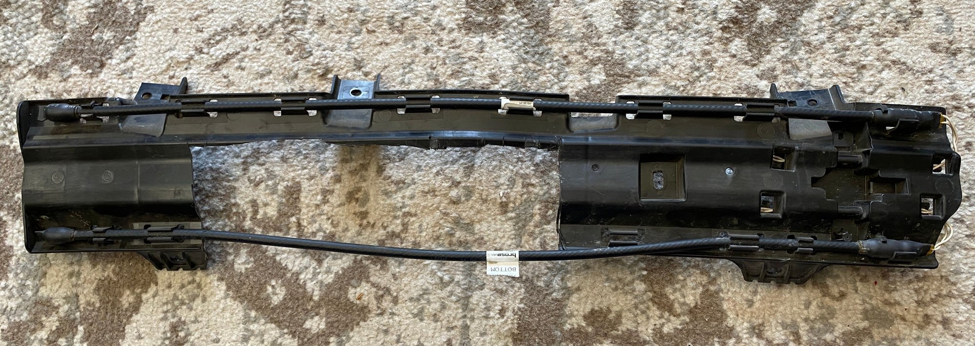

As an update to my last post, I went through the process of installing the trailer hitch on my 2022 MDX Advance.
I'm just about finished but I wanted to make some comments here since a lot of people are wondering about the installation with the Hands Free Sensor.
This image shows the original trim panel (top) with the HFS module attached compared to the new trim panel (bottom).
This shows the original trim panel (top) with the HFS module attached compared to the new trim panel (bottom).
In this image the HFS module is removed for the original trim panel. The (red sections) show where the screw holes are to mount the module, and the (yellow sections) are where the plastic tabs are used to mount the module.
This is the HFS module flipped over. You can see the actual sensors (yellow sections) are just two long rubber tubes that run along the top and bottom of the plastic.
This shows the HFS module mounted in the new trim panel. As you can see, part of the plastic covers the hole where the trailer hitch comes through. Also, you can see the (red section) is the only place the HFS module can be attached. The (yellow section) on the left has nowhere to mount, and the one on the right is too far from the hole to use the plastic tab. I'll probably use a plastic zip-tie there.
This shows the HFS module mounted in the new tirm panel. As you can see, part of the plastic covers the hole where the trailer hitch comes through. Also, you can see the (red section) is the only place the HFS module can be attached. The (yellow section) on the left has nowhere to mount, and the one on the right is too far from the hole to use the plastic tab. Ill probably use a plastic zip-tie there.
These are the trim panels flipped over, and you can see on the new one (bottom) that the HFS module blocks the hole for the hitch.
[img alt="These are the trim panels flipped over, and you can see on the new one (bottom) that the HFS module blocks the hole for the hitch.
"]https://cimg7.ibsrv.net/gimg/acurazine.com-vbulletin/2000x1124/img_4085_bd07cc766c39cd4676cb69d8f79e6d6767a76026. jpg[/img]
Closer image of the one above.
Closer view of the previous above.

This is a close up of the HFS module mounted to the new trim panel. You can see it's only connected by one screw (red section) and I'll probably put a plastic zip-tie for the (blue section) just for a little extra support.
This is a close up of the HFS module mounted to the new trim panel. You can see its only connected by one screw (red section) and Ill probably put a plastic zip-tie for the (blue section) just for a little extra support.
You can see where I put some black tape to hold down the rubber sensors to the trim. I'm sure I'll end up changing that to something better.
[img alt="You can see where I put some black tape to hold down the rubber sensors to the trim.
Im sure Ill end up changing that to something better. "]https://cimg0.ibsrv.net/gimg/acurazine.com-vbulletin/2000x1093/img_4094_50badea9104d614bdedfc32d5b244ed6eeee3634. jpg[/img]
BTW, I semi-mounted the new trim piece on the MDX and the HFS sensor works fine. Of course now I have all these warning lights popping up so I have to see what that's about.

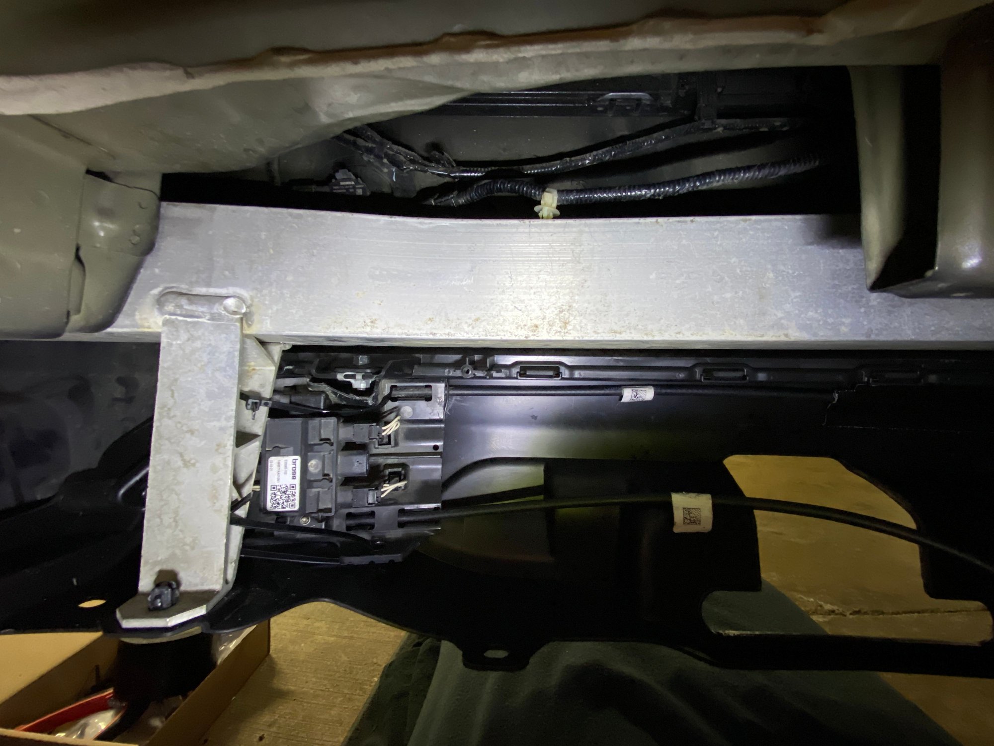

OK, another progress report.
I ran into a couple of problems, namely the hitch wouldn't fit with the HFS module mounted where I put it. I had to do some improvising.
With the HFS module mounted like in this picture, the trailer hitch was blocked by the sensor and needed about 1" more room to fit properly. I had to improvise.
In this closer shot, you can see where the HFS module mounts with the philips screw.
I'm guessing the after-market HFS module fits in the same place, so it must be much slimmer to allow the hitch to fit, or maybe it's mounted further to the left.
I ended cutting even more plastic off the HFS module, including the area where the screw hole was (red section). You can cut the crap out of the HFS module as long as you don't cut the two sensor bars or the control panel.
This is the HFS module mounted to allow the hitch to fit properly. I pushed it over about 3" to the left, so the end of the plastic (yellow line) now lines up with the screw hole. There's nowhere to mount it, so I'll probably use a zip-tie and attach it to that metal bar on the left. I might also use some two-sided sticky tape on the back. I taped the sensor bars to the trim piece as before.
BTW, I used a Crescent Wiss 8-1/2" EZ Utility Snip I bought off Amazon for $11 to cut the plastic, nothing fancy needed.
I got everything installed and it all worked, including the HFS sensor. Then I realized I didn't connect the 7-pin power plug to the hitch, and it can't be done with the trim panel in place. So now I need to remove the hitch, plug in the power connector, and then reinstall the hitch. What a PITA.
I just wanted to document my progress and shed light on adding a hitch with the HFS module. I hope this helps somebody.
