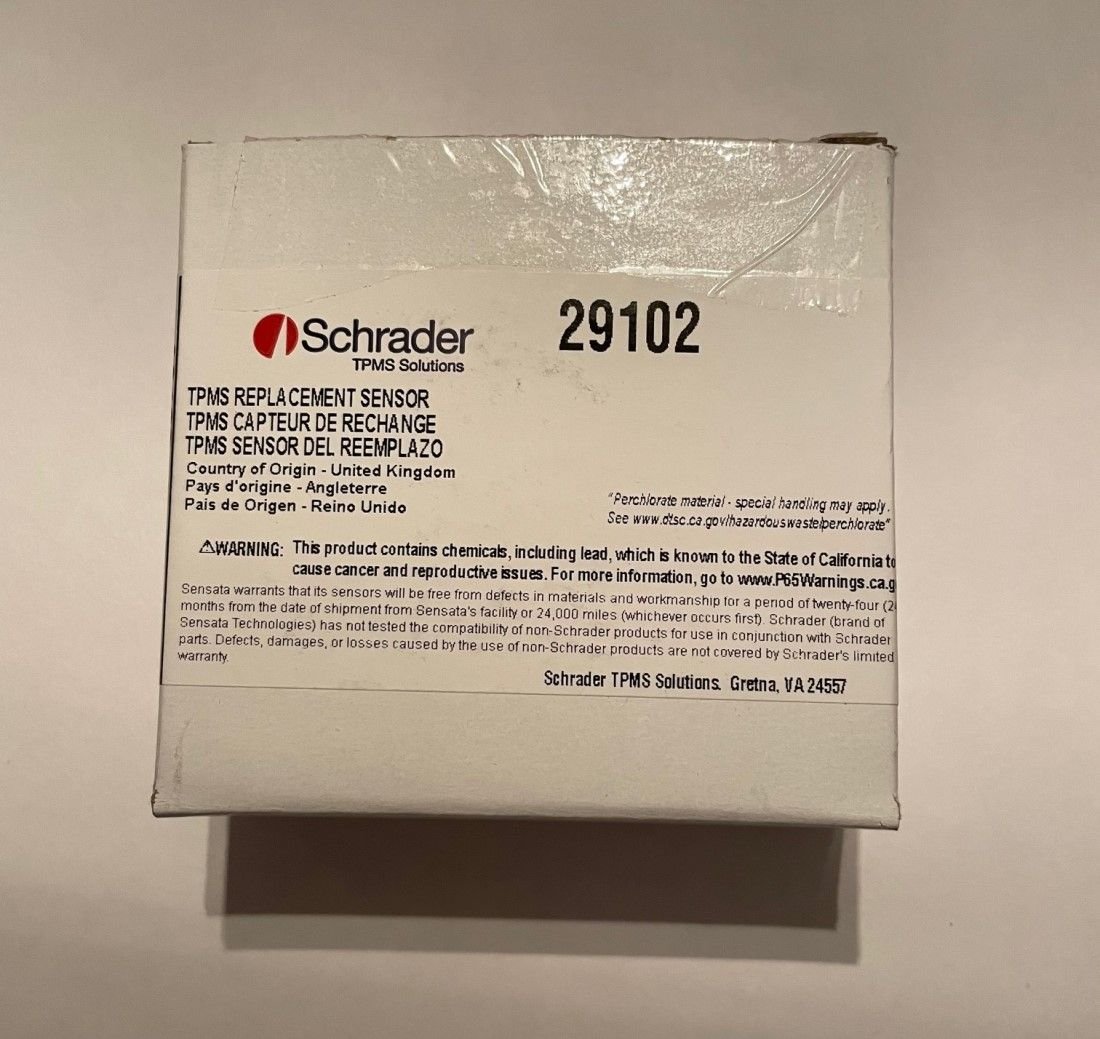

I have four new 17" stock TL rims that I'm going to be putting the tires on. I'm sure the TPMS sensors that are with the rims now on the car are original, so about 15 years old. Since I don't really want to transfer over the old TPMS, I did some research on new ones. $49 per sensor from Honda was a hard nut to sallow. I looked on Tire Rack, and they advertise a TPMS sensor with the part number 28981 at $40 apiece. Doing a google search using that part number showed it to be a Schrader TPMS sensor, and that part number has been superseded by newer part number, 29102. Rock Auto had that sensor for about $22 each, so it was a no brainer to get them from there.
I guess my question is when it comes to the TPMS installation on the new rims. Looks pretty straightforward. I was wanting to know if someone can confirm the 35 In-Lbs (about 3 Ft-Lbs) torque value on the nut? I saw that here on Acurazine, but it wasn't for a TL. Just wanted to confirm it is the same for the TL.

Just found this info on the 29102 sensor on Schrader's website...
https://catalogue.schradertpms.com/e...9_2008-12.html
Looks like they are calling for 71 In-Lbs torque value on the nut. I e-mailed them just to make sure.

I received an e-mail from Schrader. Their torque spec for the nut is 71 In-Lbs, so it is different than what Honda calls for on the OEM TPMS.
I received the 4 sensors the other day from Rock Auto. Here is what they look like...
And here is what they look like mounted on the stock rim...

The rubber sensors use about 35 inch pounds and the metal ones use 71
