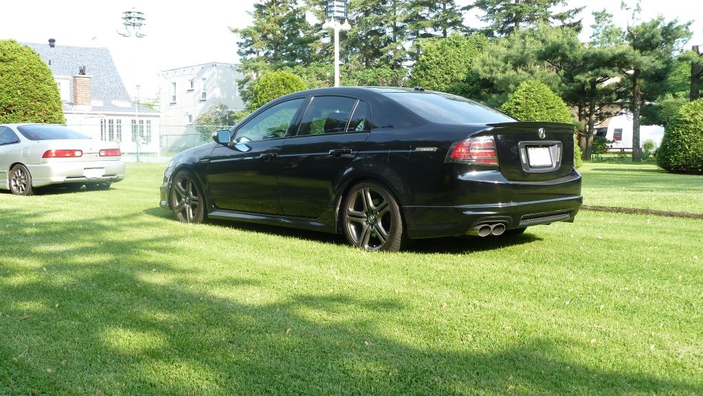

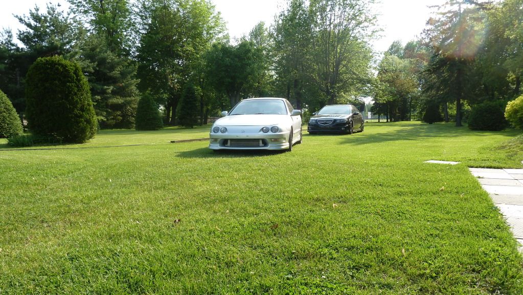

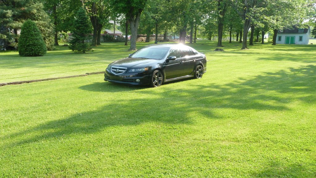

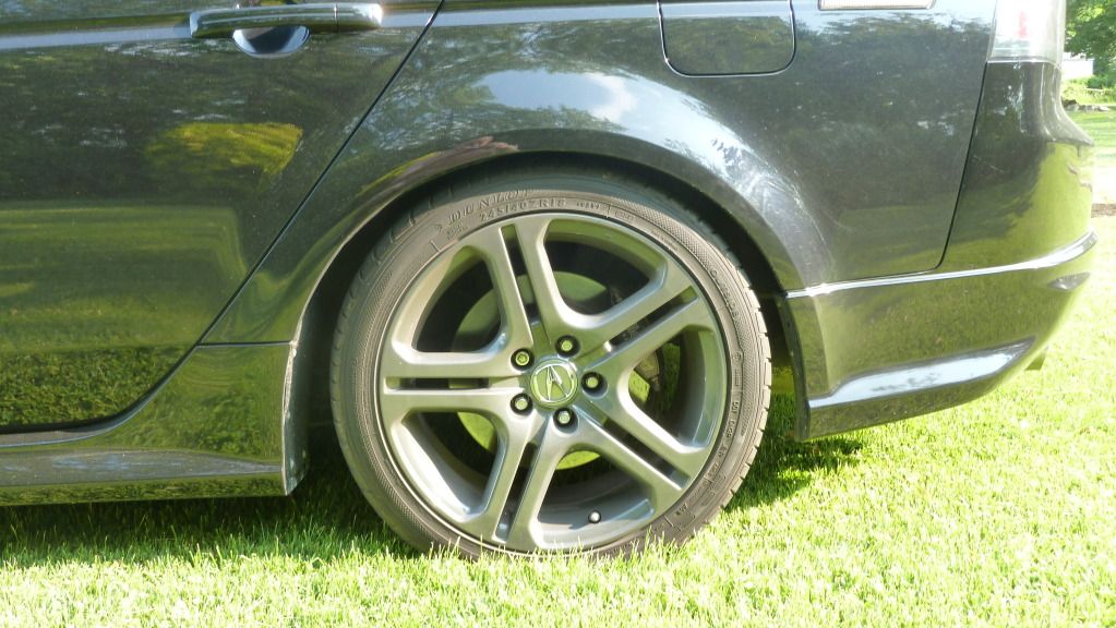

Post some pictures of your wheels
http://i1108.photobucket.com/albums/...s/P1010466.jpg
http://i1108.photobucket.com/albums/...s/P1010463.jpg
http://i1108.photobucket.com/albums/...s/P1010454.jpg
http://i1108.photobucket.com/albums/...s/P1010452.jpg
cars/wheels are dirty but it gives a good idea of the color, depending on sun and angle position it gives different effect...

Those look great!
