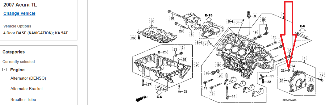

I believe that is a valley drilled in the block that leads from the area in between the cylinder heads to allow for drainage. Also, there is an oil passage o-ring above the rear main seal (behind the cover plate) that tends to leak. Both the rear main seal and the o-ring should be replaced to avoid having to go back in there, along with resealing the cover plate with Honda bond.

Originally Posted by AMTMJ
I there is an oil passage o-ring above the rear main seal (behind the cover plate) that tends to leak.
Can you please show me it on the diagram. I cannot find the number. My mechanic reseated the rear main seal, however it seems the oil still drops under the car.
Old Feb 16, 2026 | 11:37 AM
Posts: 6,909
Likes: 2,211
This is were it goes on the rear cover plate above the rear main seal.
