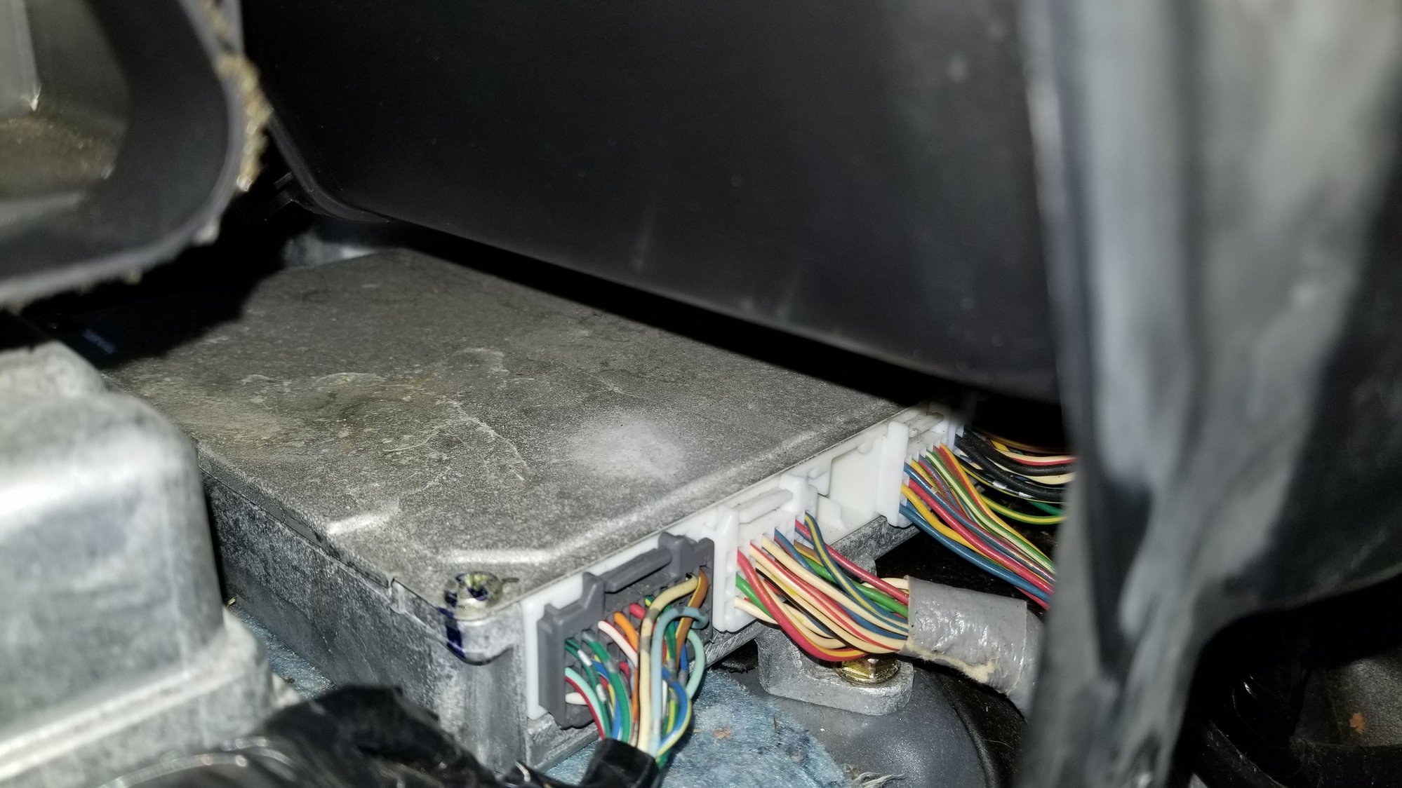

Anyway, I exposed the ECU this morning. Bone dry in and around the area under the dash, BUT, I'm pretty sure that the dust on top of the ECU looks like it water had dripped on it and dried. See photo below.
I'm going to try and limp this thing home in a few minutes so I can work on there over the weekend. My plan is remove the ECU and take the cover off to see if it's possibly still damp inside. Just hoping that, if this is ECU related, it isn't damaged.

looks like water drippings on the ecu. Did you first try to remove it and see if there is any water in there? the top cap isnt water-resistant.

- I pulled the ECU, removed the cover and let it sit overnight in case there was any moisture inside. There were no indications of water intrusion, but it cost me nothing to try it. Reinstalled, no change. I'm assuming ECU is OK.
