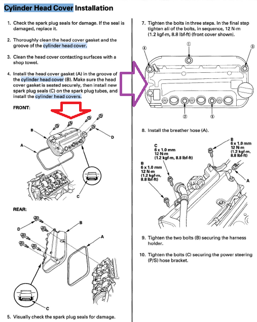

Posts: 6,909
Likes: 2,211
1) Determine the metric size and thread pitch of the valve cover bolt threads (red).
2) Search the interwebs for a potential helicoil kit for said metric bolt thread size.
3) Determine which corresponding valve cover cylinder head bolt boss' are stripped (purple).
4) Perform helicoil repair process for those determined in need?
Good Luck

I wouldn't be surprised if the previous shop or someone else damaged the threads before you took it apart. Looks like the threads came out of the hole. You should be able to repair with a Helicoil.
Spec is 8.7 ft/lbs of torque which is very low for most torque wrenches.
Someone had a similar issue to you 11-years ago and posted that they used a helicoil (last post)
https://acurazine.com/forums/3g-tl-p...gentle-903543/
Have you checked the valve covers for damage? Are you using hondabond on the areas that are leaking on the gasket?
I see your your post about the coil blowing out, that is common on Cyl 2/5 due to the head cycles and the proximity to the exhaust ports. The spark plugs can loosen themselves over time and cause BIG issues. I'm not sure if it's related to what happened this time around. Do you know how they repaired it with the coil blew out?
