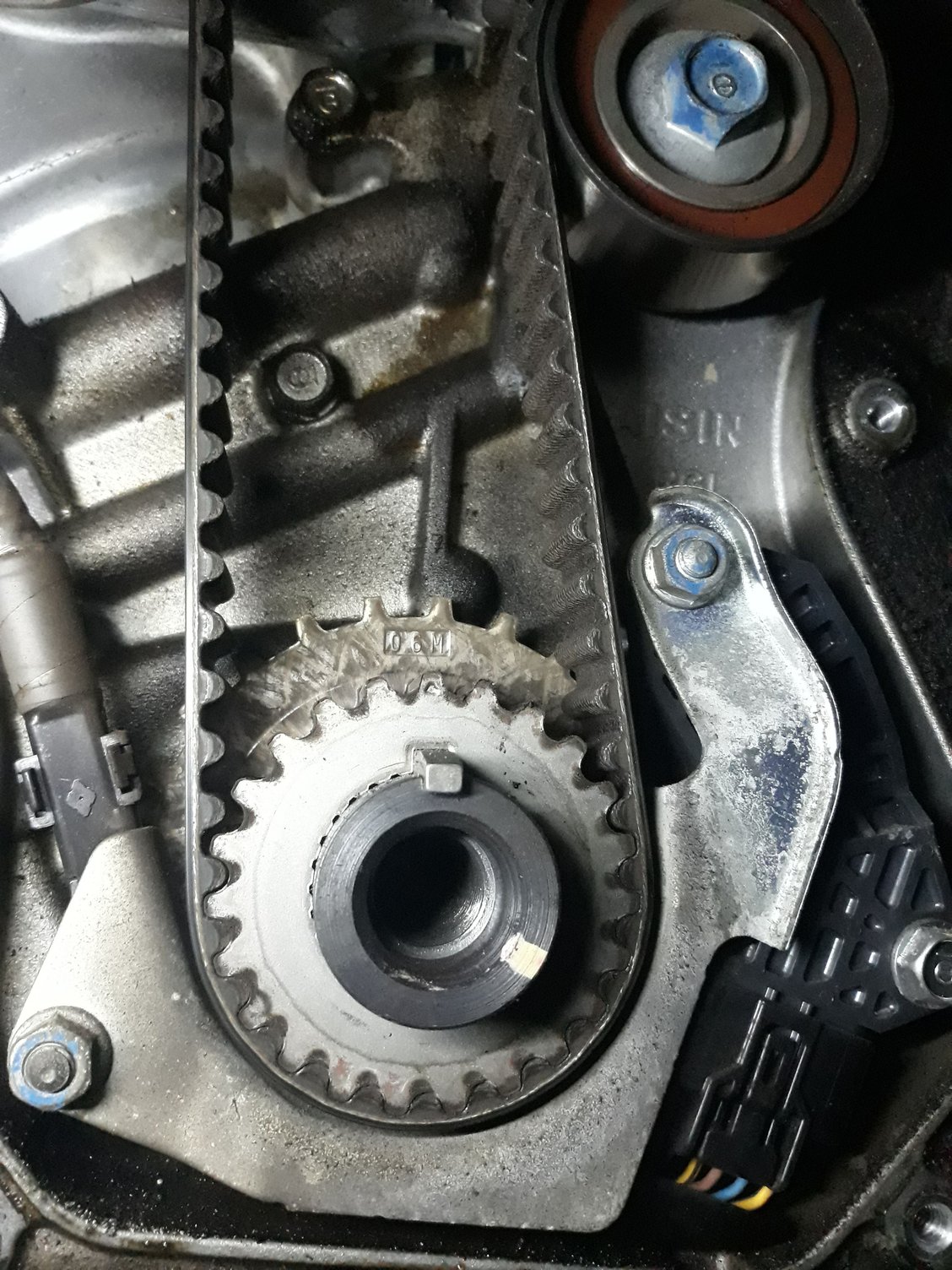

I tore into my 08 type s today to find how just how bad the noisy tensioner is and to see what else is going on inside as I've only had the car a week. Soon as I get the top covers off I find out there is a solid 3/4 inch of slack in the belt, I've never done a J series belt before but that is definitely not a good sign. The sun went down right as I got to the point where I would make my marks on the belt then remove it, I took some pictures of how my timing marks are lining up and wanted to see if everything looks in time to you guys considering just how bad this belt is, it was like a ticking time bomb imo and I luckily got to it in time so long as I can get the job done right. Any ideas as to why there would be a mark on the crank? I was thinking maybe from the last timing belt job. Any input is appreciated.

Marks look fine. There's no need to mark the belt. Yeah, 3/4" doesn't sound right.

Yeah, probably, unless you have valve damage from the slack TB. But if the marks all lined up before pulling the old belt, then you could/should be damage free. Pretty lucky that that belt didn't hop a tooth or two on the front cam sprocket.
