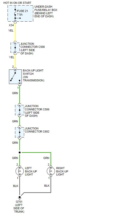

Fuse, switch, wiring, bulbs? How far you want to go?
Pretty simple circuit. Check under-dash fuse #21.
If good then I suspect back-up light switch. It's located under battery, under battery tray, on top of the transmission.
Relatively easy to get to. Hardest part will be bottom bolts of battery tray.
Put ohm meter on that switch. It should be closed when transmission in reverse.

I had this problem in my old Neon.........turned out to be the backup light switch in the stick shifter.
