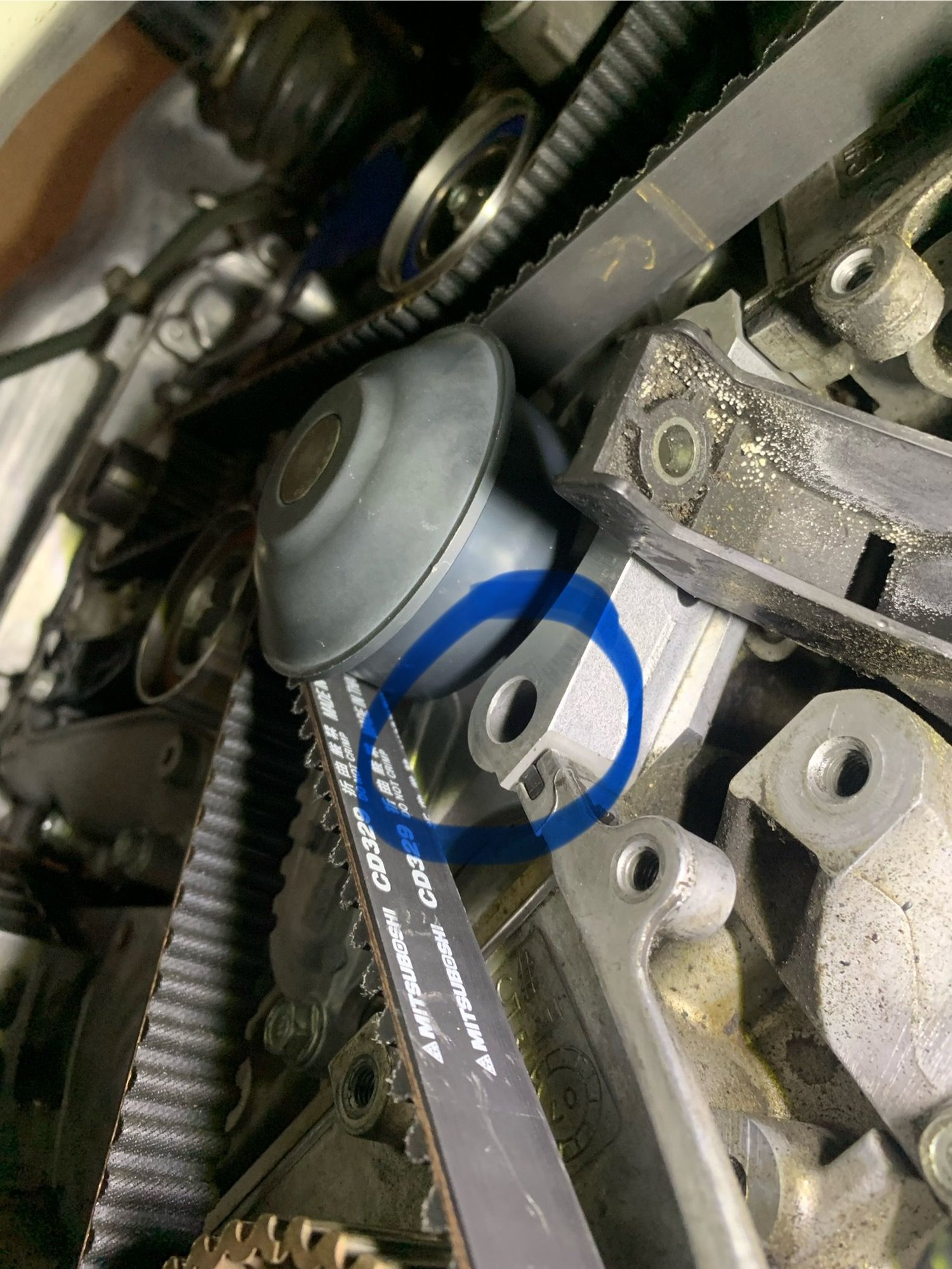

Just did my first timing belt this weekend. Went to put on the big side bracket and realized one of the holes was stripped. The first few threads. With bracket off i screwed bolt in and it catches about a third of the way in and screws in fine. But with bracket in place it wont reach the good threads. So far ive been told helicoil or timesert, just screw a stud in and use a nut (which is what im considering if i can find somewhere to get a stud and if theres room for the bracket to slide out), or try a longer bolt (but ithink it would bottom out before getting torqued properly. Or even the copper wire trick. Has anyone just used a stud/nut for this? Just trying to keep from having to take water pump off to drill it out as id have to remove timing belt again etc. but if thats my only option it is what it is.

Just to clarify, the picture below indicates the 'big side bracket' in question?
If so, maybe take the bolt to a local Ace hardware and try and determine original size, then, see if they have one just over the size needed, in order to catch the deeper threads?

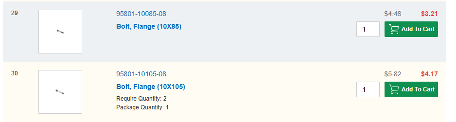

It looks like #29 or 30 below?
yea that top right bolt #30. Does it not seat all the way in when torqued? I figure a longer bolt would just bottom out before getting it tightened down. I notice honda does make a bolt 5mm longer i could give it a shot

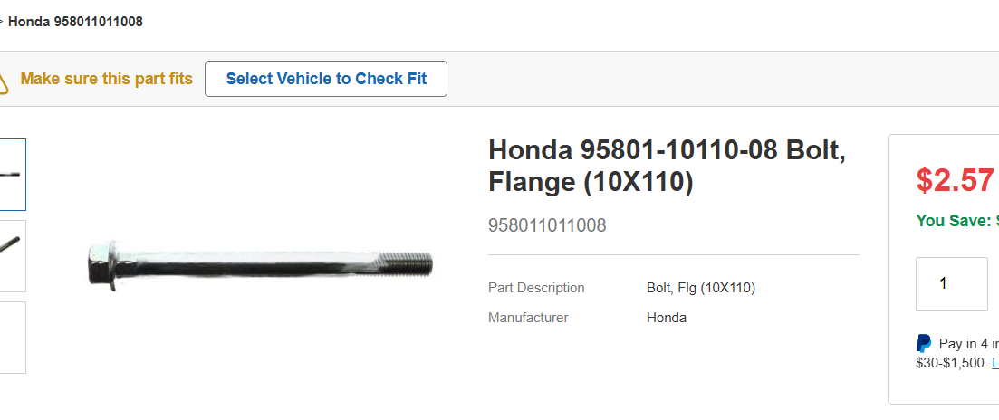

To find joy with a longer bolt (110), like the one below
You have to carefully determine how much thread 'meat' you have to grab at the end.
It's important to determine there's enough room at the end of the 'boss' so one does not punch through , sometimes an extra washer can be added to provide that extra millimeter of space before maxing out at the bottom / end of the 'boss', get what I'm saying?

Originally Posted by Fl285
Have you fix it?
not yet. I grabbed a stud and nut tho which i need to cut about an inch off..also grabbed that longer 110mm bolt i will try first. Im gonna mess with it today

Originally Posted by wilspainar
Zeta's advice on the longer bolt is your best bet outside of using a timesert.
so the longer bolt works and i snugged it in (not torqued yet). Bracket is tight. But i worry if im bottoming out/damaging the block if its slightly too long? I stuck a washer on the bolt to take up a bit more length but then it engages less threads. And because its the bolt that goes into that deep hole on the bracket i cant tell for sure if its pressed all the way against the bracket.
If you don't have a small caliper with a depth measuring function that you can maneuver within the bracket bolt passage, use something with the bracket in place, to get an idea. A straight cut piece of measured clothes hanger rod, for example.
Insert it as far as it will enter, within the bracket & block, than measure to the flat area of the bolt passage bracket, where the bolt flange will contact.
Compare that number to the new 95801-10110-08 bolt to get an idea of what you have to work with, depth wise.
