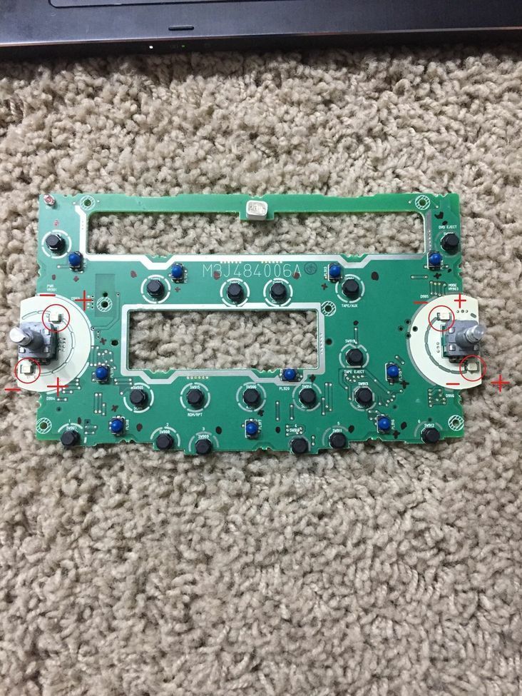

https://acurazine.com/forums/third-generation-tl-2004-2008-93/diy-radio-led-modification-962168/
Image borrowed from wusty23jd
Those blue things are 'standard' bulbs with blue rubber condom on them. Either replace your old bulbs with new (if you can find them somewhere) or replace them with LEDs.

Yes they are soldered. Not that hard to replace. I heated one side up, used pliers or flat screwdriver to lift the bulb on that side, and then heated other pad while lifting whole bulb. 90% of the work is getting radio out of the dash.
Replacing the front board would work, but that's a lot of work and money for not much gain. And then what if 'new' board bulbs will burn out week later.
Front panel has nothing to do with the code (well I never tested that, but it has single chip on that board that 'encodes' the signal so it requires less pins to transfer data from buttons to the radio, shouldn't have anything to do with the code)
I would say either do it right (replace all bulbs with new or replace all bulbs with LED) or live with it.
And then worst case, if something goes bad, you can look for another radio or panel.

So I guess my easiest solution is to get some bulbs from a scrapped tl and solder one in. From that picture of the board above, it looks like 1 bulb lights up 2 numbers.
