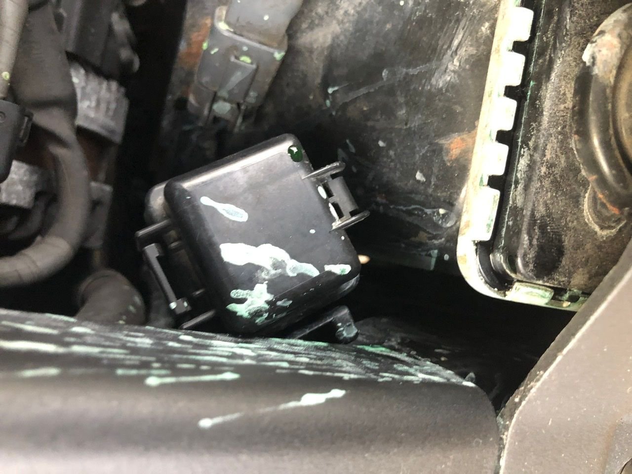

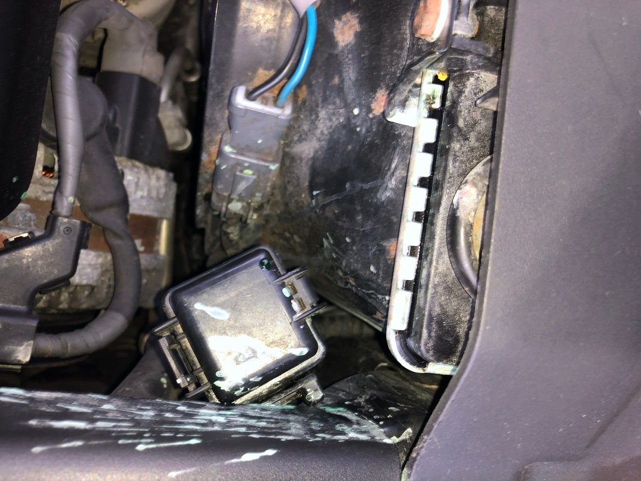

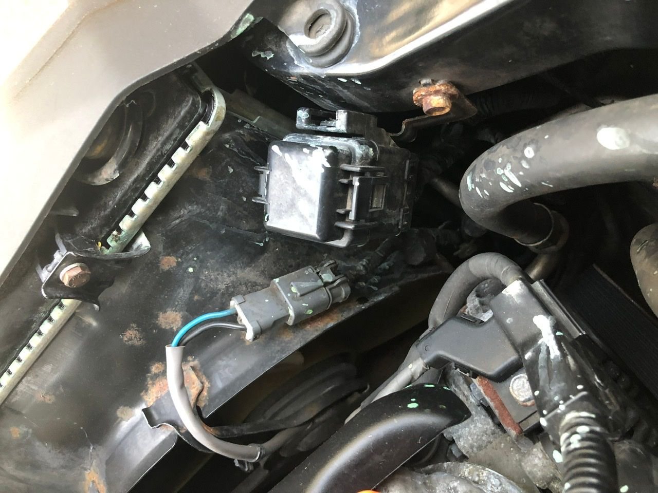

I just opened the hood to replace a cracked piece of my intake and discovered radiator fluid spray. Anyone seen this kind of thing? Hoping against hope that it isn’t too serious but ... meh.

Unfortunately, there does not seem to be a hose or other "easy fix" in that area. Any chance you can remove plastic cover to pinpoint the leak?

I removed the cover and nothing beneath it had splatter. Based on the splatter it seems like it came from the top corner of the radiator itself, but is that even possible?

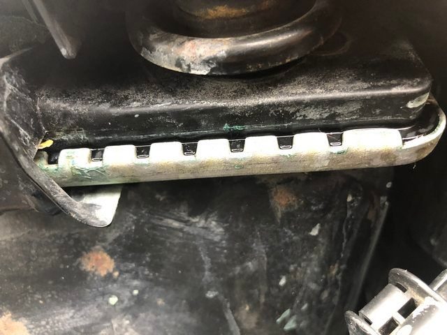

I see tell tale sign of cracks in between where the top plastic piece meets the aluminum. You can find out either from pressure testing or warming the car up to temp while having the hood open to identify it. The latter is dangerous as you might overheat once the coolant level gets low.

So I started up the car and let it warm up, watched the whole area and did not see any leaks or splattering. But I agree, it certainly seems like there is seepage along the top of the radiator where the plastic meets the aluminum.

Those seams are a common failure point. Time to replace the radiator. Grab a DENSO replacement on Amazon for half the price of OEM

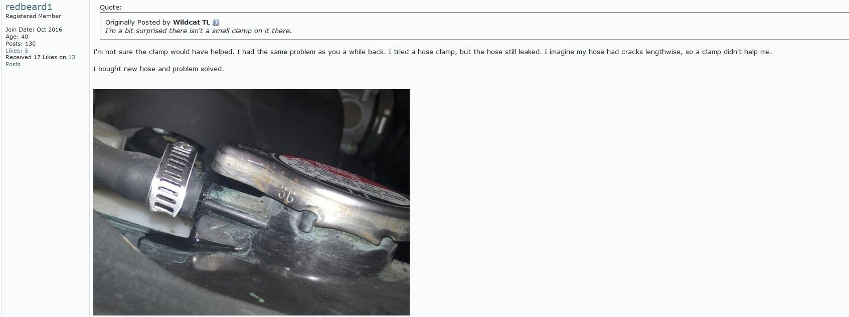

If your leak is coming from the hose, I'd replace the hose. It is a $3 part and takes less than 1 minute to replace. These hoses fail often. Mine did. ( 19103-RCA-A00).
https://acurazine.com/forums/3g-tl-p...p-hose-974974/
