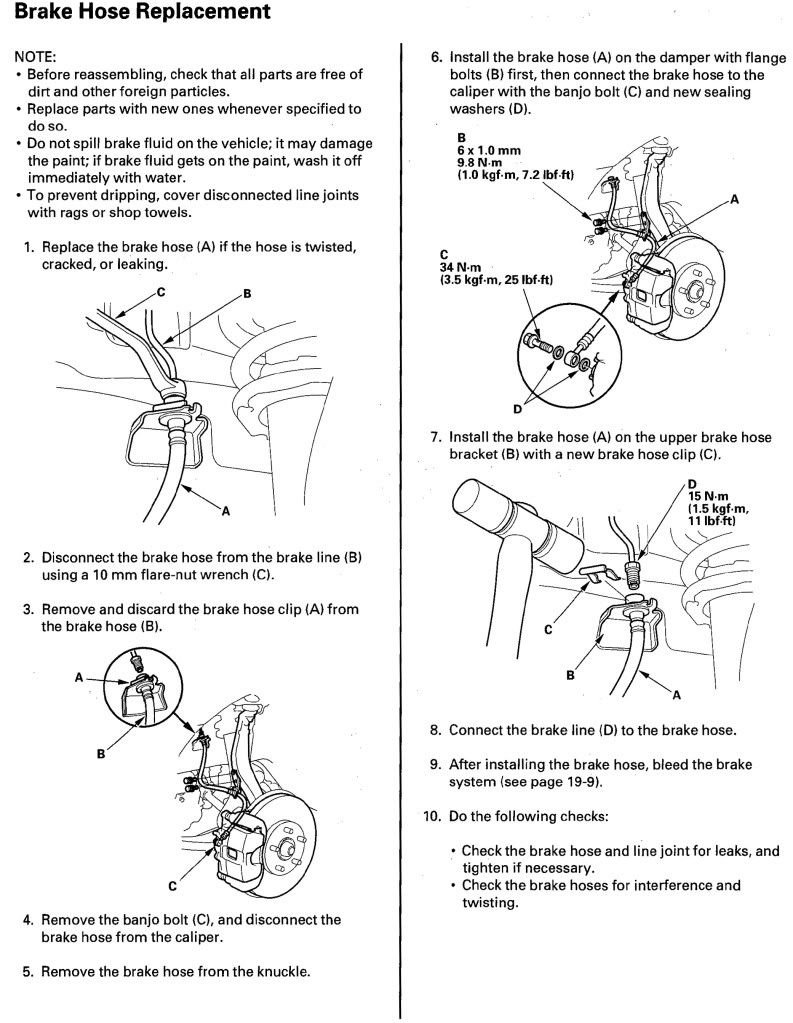

But you DO have this. Here's the Service Manual Page for an '04 TL (check step #6):

next- this is in the factory repair book -
if you have opened the lines for any reason-(like replacing them with SS)
test drive:
from 45mph do 2, ABS active stops- that means both feet buried on the pedal and pedal pulsing rapidly under your foot- may need slick road- throw water on one side of car path, dirt etc,, and some quick turning of steering to simulate going around an accident while under full braking should trigger it
As soon as stopped, get back to 45mph and repeat max effort ABS stop
IF on the 2nd try you felt firmer more solid pedal, there was air in the abs controller- happens all the time doing the SS line install as lines are all open for a bit, with major fluid loss
Assuming better pedal on 2nd test-
that air has now moved to the calipers- on mine it was just LF but you always rebleed all of them in the lf rf rr lr order to get air out--air is tricky about hiding and makes for spongy brake pedal
The ABS plumbing is why the funky bleed order,,
its no longer the logic of farthest brake from master first- now its longest abs plumbing and cross plumbing
