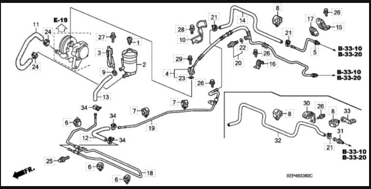

I have a decent leak in my power steering system. Definitely leaving spots on my driveway after every drive. Can anyone help me to identify the 2 hose part numbers that are in the yellow highlights? I have leaks coming from where the 2 black arrows are that are flagged with the A in the diagram. I'm looking to replace the 2 short hoses in the yellow highlights and hoping to just leave the lines alone since I'm guessing the lines are less apt to fail. I'm open to buying them from RA or any other online source, but want to make sure I order the right parts.. Thanks in advance.

If you can identify the hoses on the parts diagram below, follow the link below to their corresponding parts #'s.
#12 & #13?

Some posters had good luck just tightening the clamps. I ordered the hoses several years ago, but tightening the clamps has stopped my leaks so far.

Thanks @redbeard1 , I left it apart in the garage today while I wait for the parts to arrive. Will try that tomorrow and see if it improves at all.
