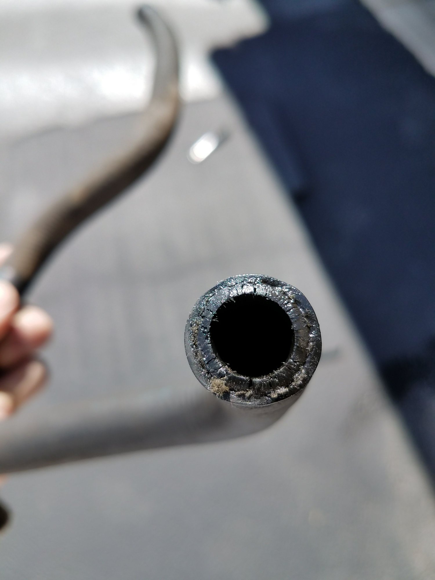

You might have to replace the hose that's the hardest one to replace of all, the one that crosses the subframe by the passenger side. I replaced mine and it took me a long time because of its hard to reach location behind at the bottom of the engine. The ends of the hose basically cracked and opened up. I was getting a leak, but not as bad as yours.

Here are some pictures of the hose I replaced.
