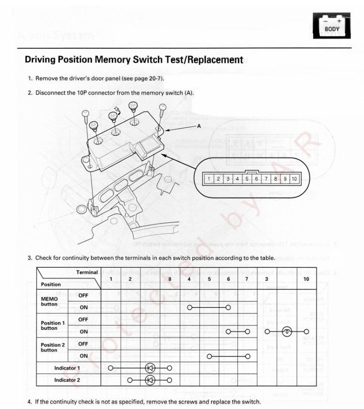

ok found something... Memo continuity test works, Position 1 works, But position 2 I get continuity on 5-6 and not 5-7. Is this an error in the document or my memory switch is dead?
I bought a another memory module... and it's the same as the stock one...I get continuity on 5-6 and not 5-7... And this memory module did not fix my passenger mirror problem... so I have not idea where to look now... don't want to bring it to the dealer at 500$/hours ...

Edit: I was wrong about the part number, it looks like the right one. If you put your old motor in does it work? Maybe you got a defective new one! What year TL do you have? Check the service manual and see if you can test if the pins are getting power at the door motor with a voltmeter/multimeter. It could be a broken wire from the car to door harness.
In the book I have, it's 22-330 where they start describing the system and it goes for 20+ pages and has the pinouts and wire diagrams.
