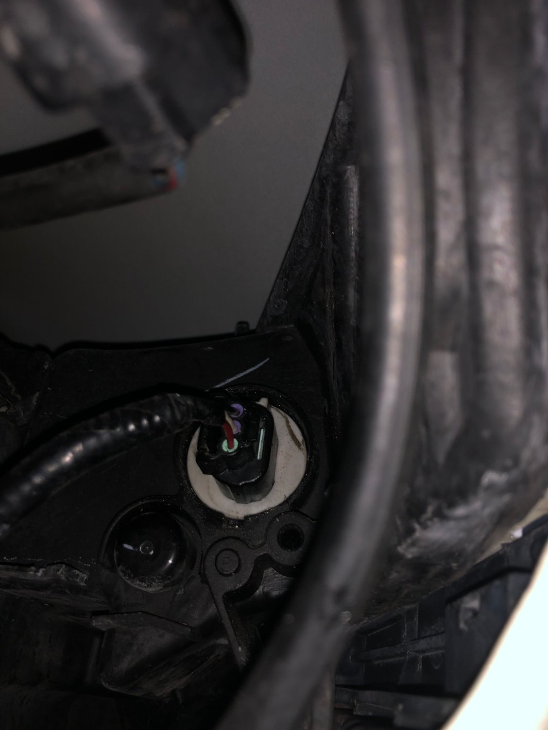

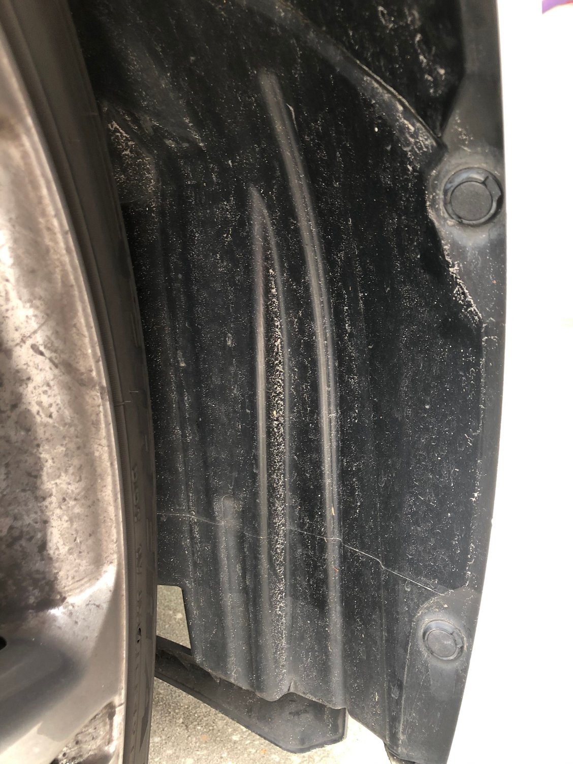

Old Dec 30, 2019 | 11:44 AM
Slpr04UA6's Avatar
-------Tim-------
Joined: Mar 2010
Posts: 2,552
Likes: 613
From: Tampa, Fl
^mudgaurd that’s funny!
Buttoned up after changing bulb.
bought new bulb for front turn signal, removed two push pins, pulled back fender liner, and undid old bulb counterclockwise, and replaced new. No more hyper flashing! Thnks for the info and easy replacement!
Unbuttoned.
