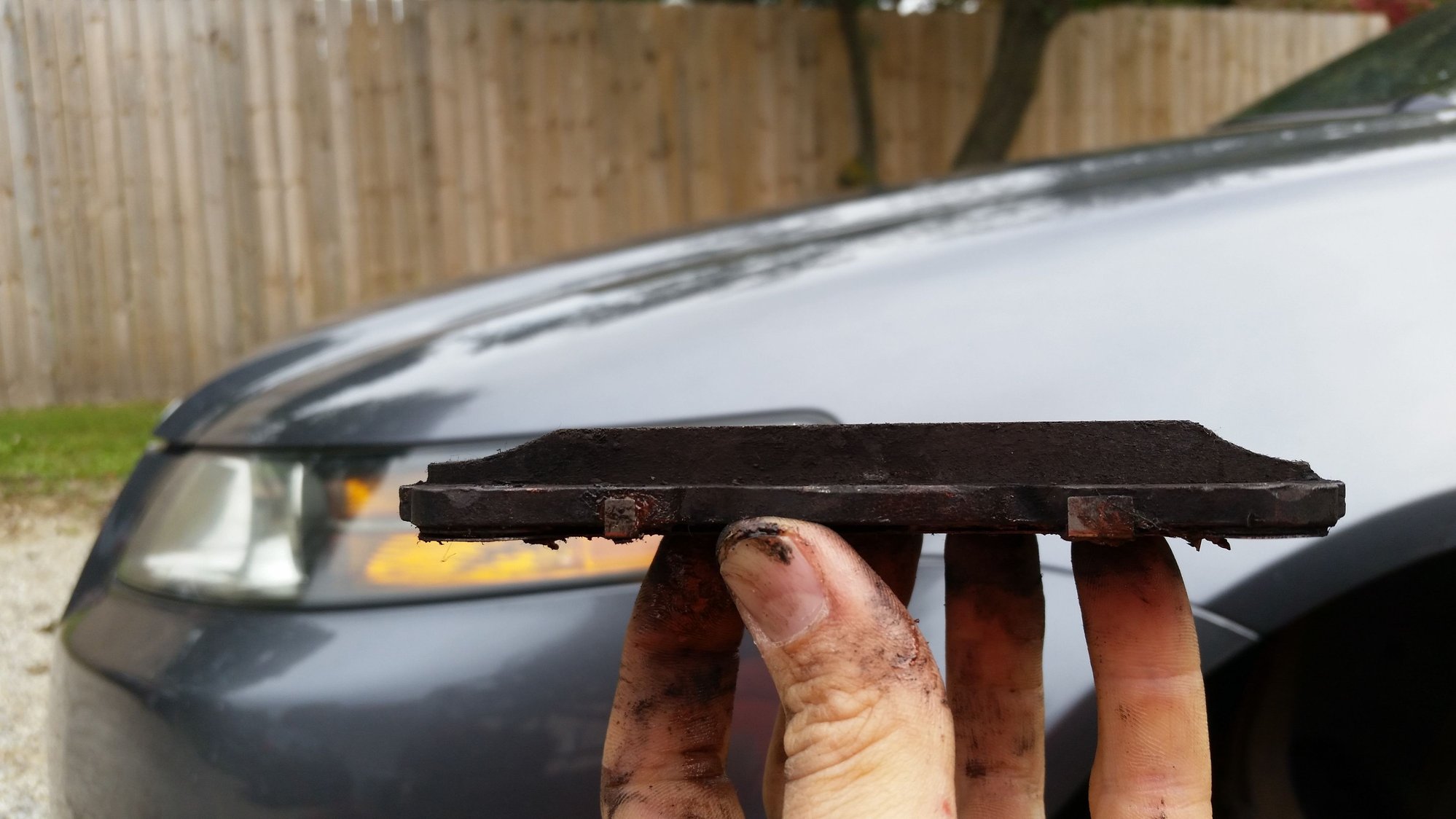

Good morning all! I have an 04 6MT tl with of course the Brembo brakes. Back in June I replaced the brakes with new OEM pads and rotors. Pistons in the calipers seemed to move smoothly and work great. Then after about 4,500 miles i started feeling my pedal pulsate, great warped rotor. So after a drive i felt the hub of the rotor to see which one could have warped. It was the drive front as it was waayy hotter than the passenger. So i did an inspection and found that it was the inside upper piston that was failing and you can see from the pad how it is worn unevenly. So to make this story short i purchased new seals and had them professionally rebuilt due to my rusted inner bleeder screws destroying the caliper threads. I did not replace the pads again but had both rotors turned since they were so new. Now my warped feeling is gone, but when i feel the rotor hub that driver side is still hotter than the passenger. It doesn't seem to be as hot as it used to get, but then again the weather is cooler here now. So i need advice or any input to how is this freshly rebuilt caliper is still causing more heat than the passenger side??? Bad rubber brake line? I have no rotor screws on that side but i have read countless threads with people who don't use them. I'm just at a loss. Thanks in advance
Inner Pad- Left side is worn lower

The pic of your worn pad above looks normal to me. Pads rarely wear perfectly even but, the heat issue is a real concern.
