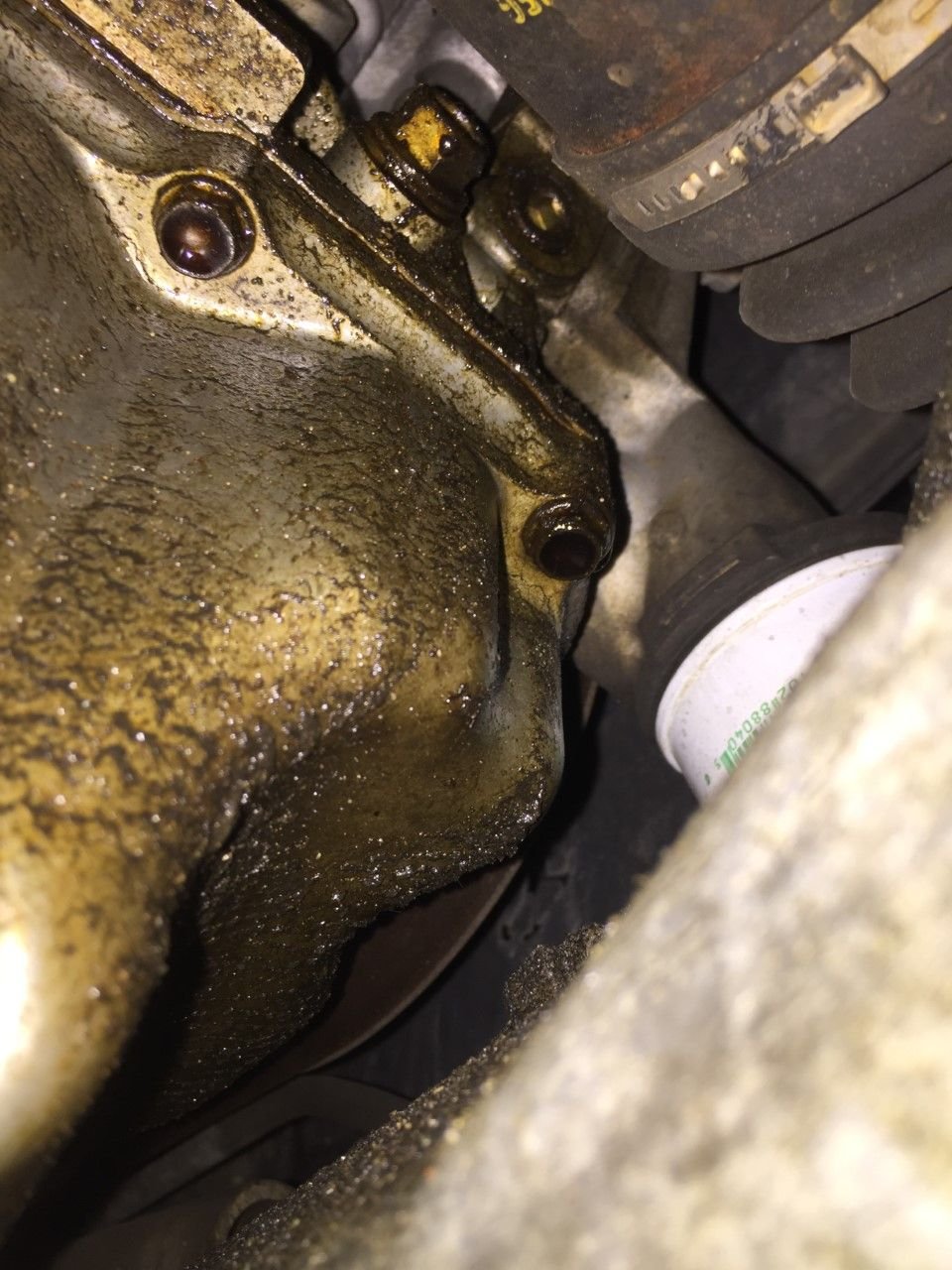

Sooooo... I have an oil leak. It's been leaking for several months now, but it's only averaging a drip or two every few days. I'm trying to save my garage floor and have been parking my TL outside for the time being.
The drips are occurring on the passenger side near the oil pan drain. After church, I got under my car and took a few pictures.
Could it be that the drain plug threads are stripped or that the oil pan drain threads are stripped? I'm just hoping it's not a rear main seal leak. I took it to a local shop to get my last oil change and I'm just wondering if they overtightened and caused some damage.The driver's side underneath is dry as a bone.
I wiped up all of the oil with a shop rag and will check it again in a few days. Does anyone have any thoughts as to what maybe causing this?

Have you put a wrench on the drain plug to check its tightness? May be the opposite of what you are thinking - could be loose vs overtightened........ Honda dealer will e less expensive than Acura if you decide to go that route.
Sorry, I should have mentioned that. Yes, I checked to make sure it was tight and it definitely was. I obviously didn't torque on it much harder, because I didn't want to risk stripping the aluminum oil pan threads.
did you replace the drain plug washer? normally its the washer need to be replace. Beside that check your oil pump assembly its the most common leak on J series motor. FIY it will require removal of the TB/WP unit to get it reseal where on the book it took 12 hours.
I did not replace the plug's washer yet. I can try replacing that and see if that fixes my problems. brapp_kid7 did my pictures look similar to what was occurring?
truonghthe, I was hoping you wouldn't say that lol. I've seen this a lot on Acurazine as well.
I'll report back as soon as I replace the washer and let the car run for a few days.

I changed my oil a couple weeks ago and noticed when I jacked up the car there was oil leaking all over the pan and around the drain bolt. I went ahead with the oil change and cleaned it all up and replaced the bolt and washer. I bought it as a kit cause it was the same price as just for the washer. I didn't see any oil leaking out, I guess the last person to change the oil didn't change the washer. If you change your oil just replace the washer it's only like $2.
So, like I said, I did a very non-thorough job of cleaning up the oil. I drove it for three days and I got under the car tonight after work to see how things progressed. Here are the results:
You'll see that there is oil leaking well above the oil pan. With that said, It looks like it might be a bad oil pump seal. Now, I have to determine what should be fixed. I bought the car with 110,000 miles and the 105,000 service was done (timing belt, water pump, etc.). I currently have 135,000. Here are a list of things I am considering getting fixed while the engine is disassembled. Let me know your thoughts on the below:

You'll probably pay $80 in seals and Hondabond if you go thru the dealer.
There is one seal behind the oil pump, one for the oil pick up, front crank seal, oil filter housing gasket and the rest is sealed with Hondabond.

If your transmission side is not moist, the rear main seal should be OK. Your oil pump small gasket is leaking, also power steering pump might also be leaking since when it leaks, it ends up on the same spot on the drain pan. Most likely it is your oil pump seal, honestly, if that is me, I would just leave it alone and wait for your next Timing Belt job to get it done, if you can live with that small leak, it will not ruin anything really, and the leak will not get worst. It's not worth to do that job specially if your TB service was just done not too long ago. My mechanic buddy told me he had that leak for about 200k miles on his odyssey and never had a problem.
Agree with Jeff above. I've had my oil seal leak for about 20k miles now and all you need to do is just keep an eye on oil levels and top off. Mine was found literally right after the 105k was done and the shop said it wasn't gonna get worse so they recommended waiting for the next 105k.

the oil leak: have u ruled out simple things like the oil pressure switch? VTEC spool valve? filter foot? looks like about the same area, id check that before biting the bullet on an oil pump
