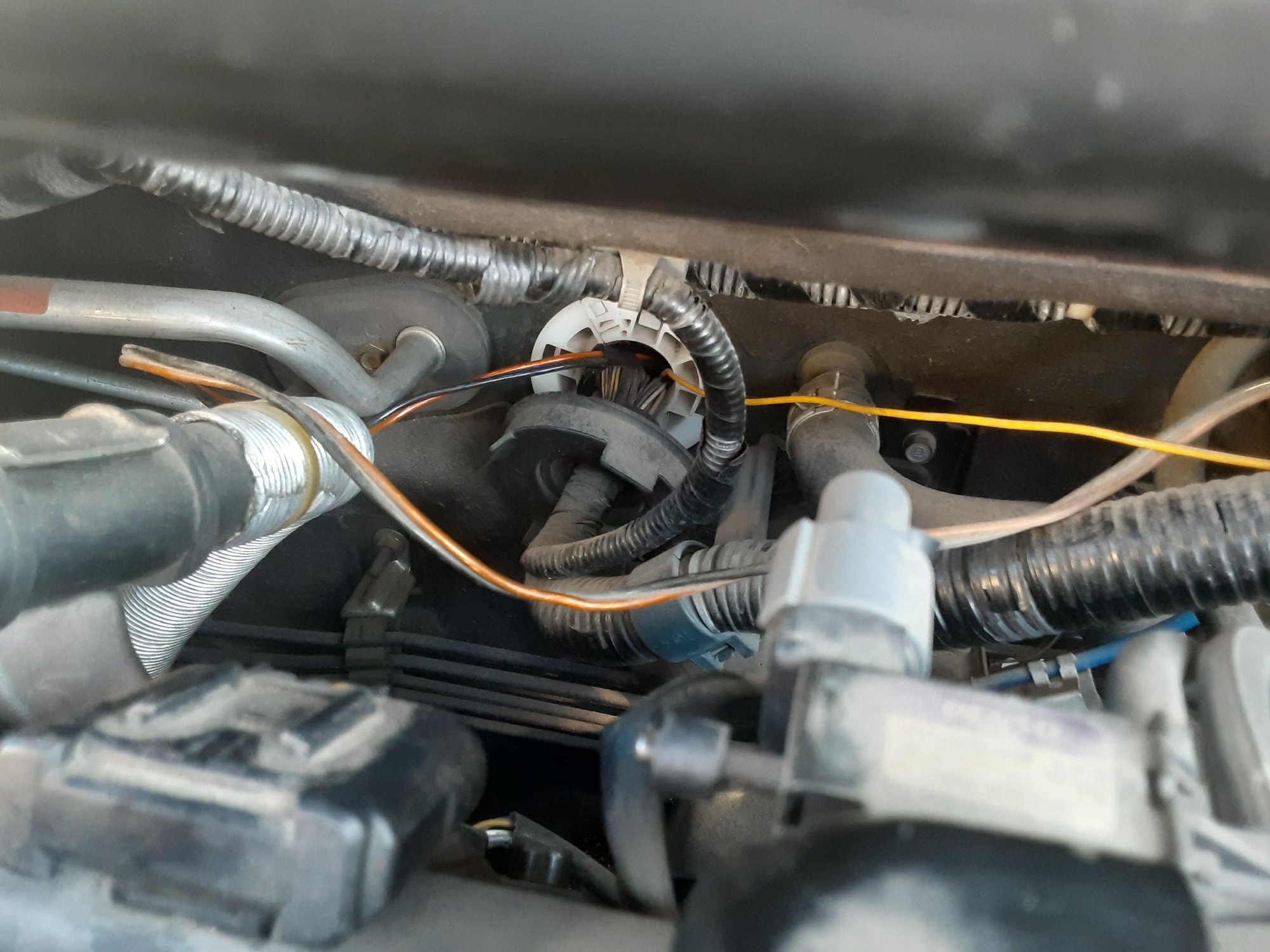

I know it's limited info but i'd like to know what I should start with first. Here are some pics of the engine bay, there's a wire that goes into the firewall that I just don't know what it's for.

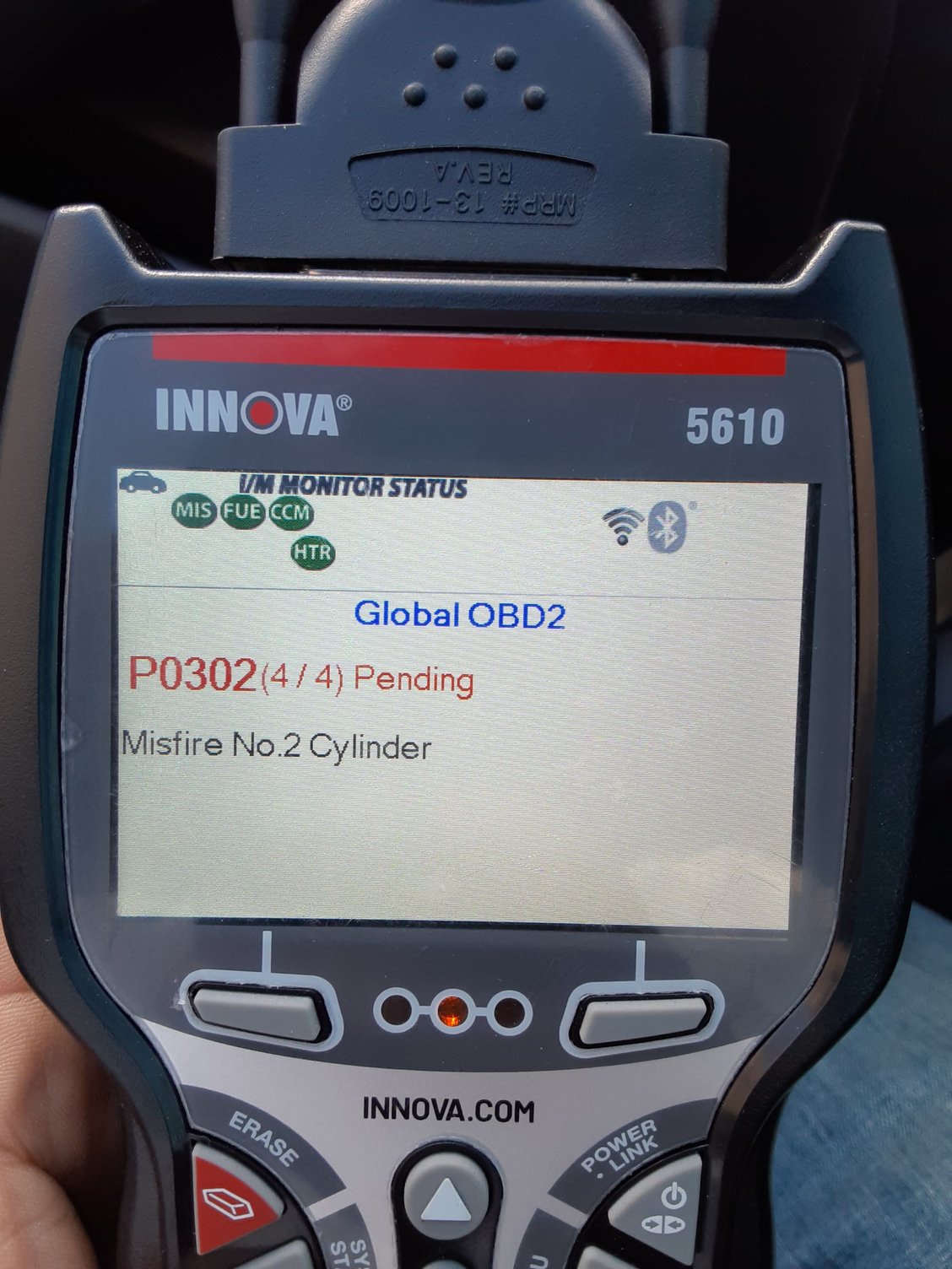

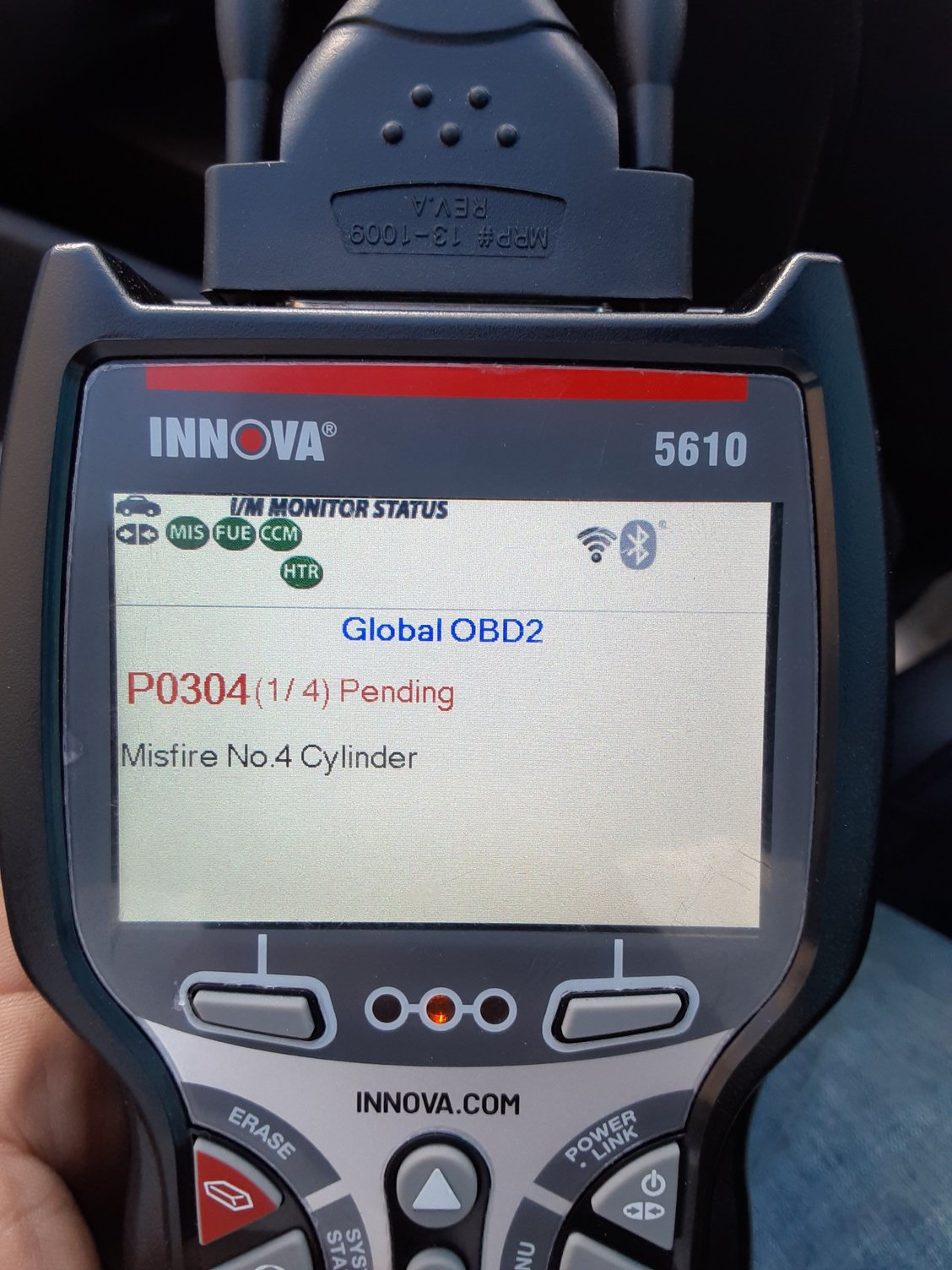

Alright, I actually got it to start, turns out the keys I had were not programmed, I got the original set of keys and it turned on. The issue it has is rough idle and the following codes.
Any idea of what it could be, has new sparkplugs, wondering if it's electrical?

Probably one bad coil pack. Unplug each one to see which one doesn't cause a change.
