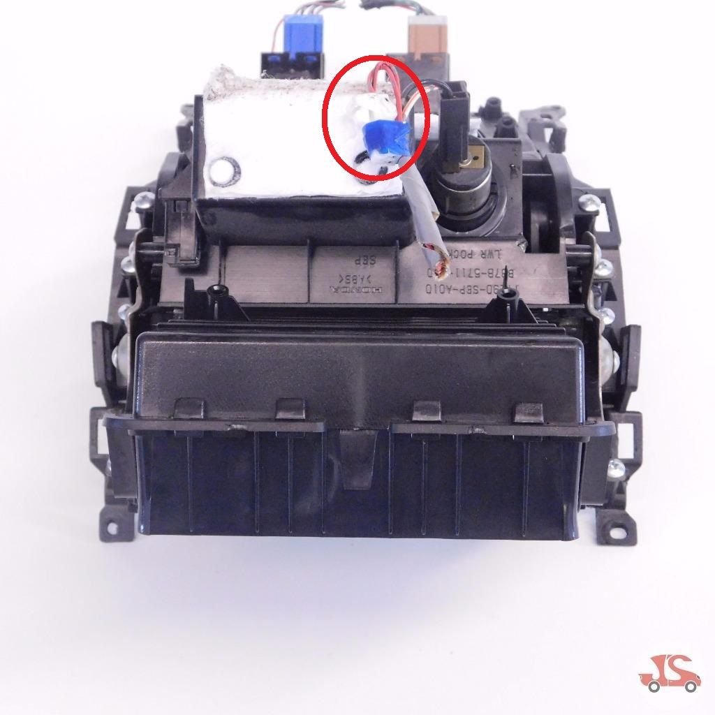

I took apart center console to look if any sockets are loose or something, all seems to be fine.
One thing which I found there is small connector along with wire which going to cigarette lighter.
any idea what is this for ?

what is this socket next to cigaret lighter wire ?
Old Jan 30, 2018 | 08:49 PM
Joecop67's Avatar
Joined: Oct 2017
Posts: 684
Likes: 84
From: Columbus, Ohio
I have no idea.
