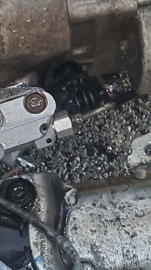

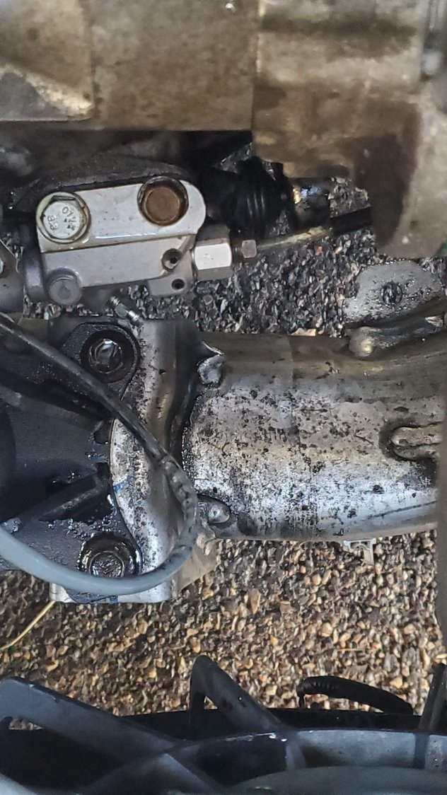

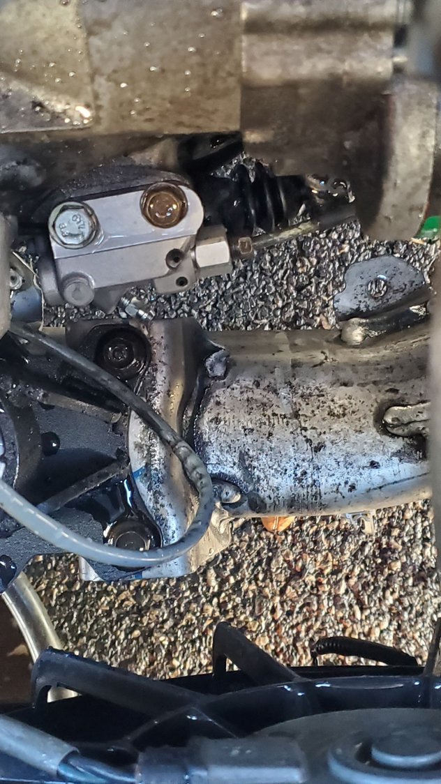

So I replaced the master, and adjusted the pedal both ways to avail. Same issue. Here's some pictures of my slave with the clutch pedal depressed and released, one set adjusted in and one set adjusted out. Not really a whole lot of difference. Looking like I have to take it apart again to see what I screwed up.
