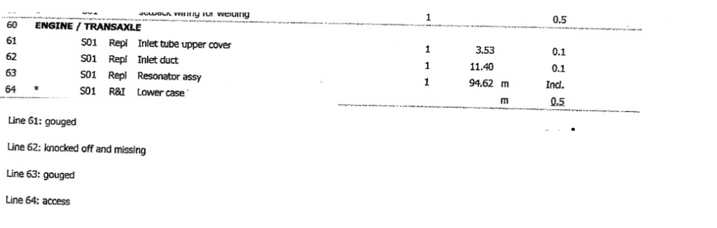

So I checked the transmission fluid again and it was low. Here is a screen shot of the work done on the car in the repair process. I don't know enough about the layout to see if it's reasonable that they may have missed something that was leaking based on the location of the work that was done.

While I agree that it's odd that the sound is on the opposite side, doesn't the transmission fluid run to both sides of the front axle? Is it possible that somewhere there is a leak on the passenger side that would cause this?
I just looked at the schematic and all those parts listed are directly above the transmission. The impact from the collision was more towards the drivers side of the front bumper. I was changing lanes to the right when the car in front of me came to a quick stop.
